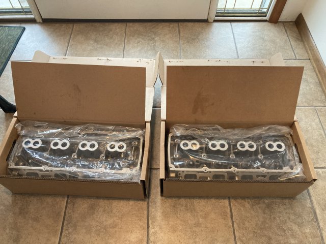

Time to get this party started!!
Only delay is going to have to let them warm up to room temperature before I put them on the block which is ready and waiting
99F93C98-9370-4F82-B0A3-42E9F1D5DD51.jpeg 15132498-4FEB-42B9-9EE3-9E540B80F31E.jpeg

Really no need to measure, you can tell by eye the difference!!
Before
ED5CAA13-4556-4C7A-9AB2-022C7F4833D8.jpeg 97E34FC1-C488-47AC-AE27-5D3FC8701B26.jpeg
After, ie now
The pocket above the valve is about the same size as the valve now!!
Replaced valve guides and all. Silicon Bronze valve guides, 5 angle valve job, back cut on the valves, TOP SHELF PRO work here no doubt. NICE work THITEK Craig!!

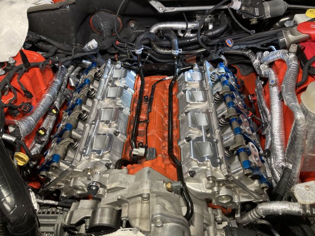

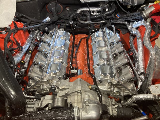

Doing the heads in the car was no fun. I chose to not put the exhaust manifolds on before putting the heads on to save weight and be able to land them exactly on the dowels without touching anything. Well that worked, getting the driver side header on pretty easy but the passenger side was a REAL BITCH!! Yesterday was pretty much consumed by putting the headers on and the exhaust system on and then last night came the valve train, checked all the pushrods for straightness, all good, set the clearance on the STANKIE valve train stabilizers and then the valve covers and filled her with cheap 0w40 PUP for startup and flush. Also bled the oil system and made sure fresh clean oil was up to the valve train. Today is more fun work up too only I’m hoping lol. my plans are to just fill the coolant system with straight distilled water. Start it up let it heat up and then dump it through the block drains and the radiator drain to get any oily crap out of the coolant system and then fill it with Mopar purple stuff in maybe take it for a hit.
A2E5D1C4-1760-4938-AB4C-F1581C888EA1.jpeg 28A7672C-43F4-4E39-8492-FF6A1E184F20.jpeg BCC5B096-A786-4A1F-83D1-35A5264253B7.jpeg 90916EE9-FF38-443D-BCAD-D5050856E69D.jpeg 38AD04E7-B5F0-47B9-956A-4E5933DA6B88.jpeg
See the oil on the 2 rocker stands each side? That’s what oils the top end.

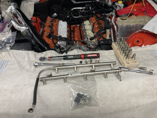

Any reason you have not switched to redeye fuel rails?
I dont like the idea of cutting up $300 fuel rails.
Will be putting on ported Redeye Fuel Rails this time around!! We’ll see if they help with fuel delivery or not compared to ported regular Hellcat fuel rails or not.
Ported out sizes match what was done with regular HC rails
