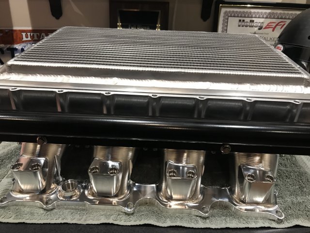

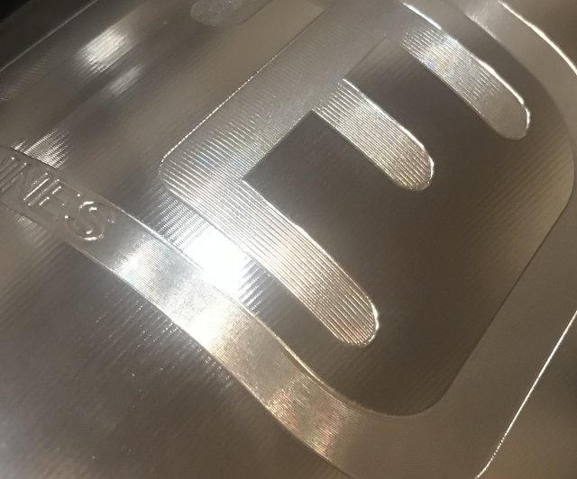

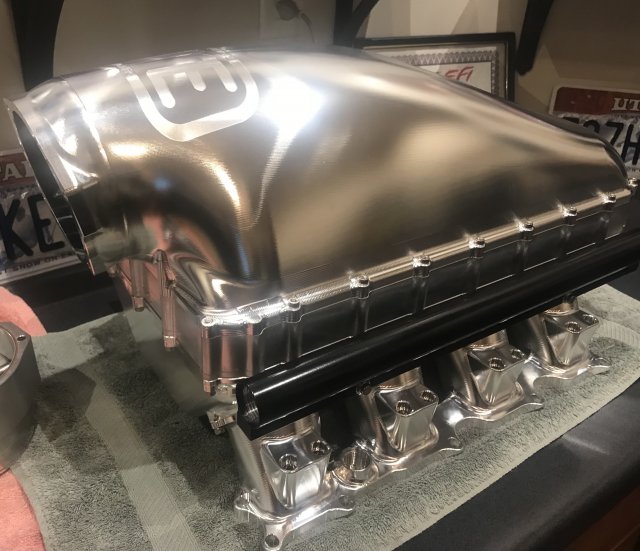

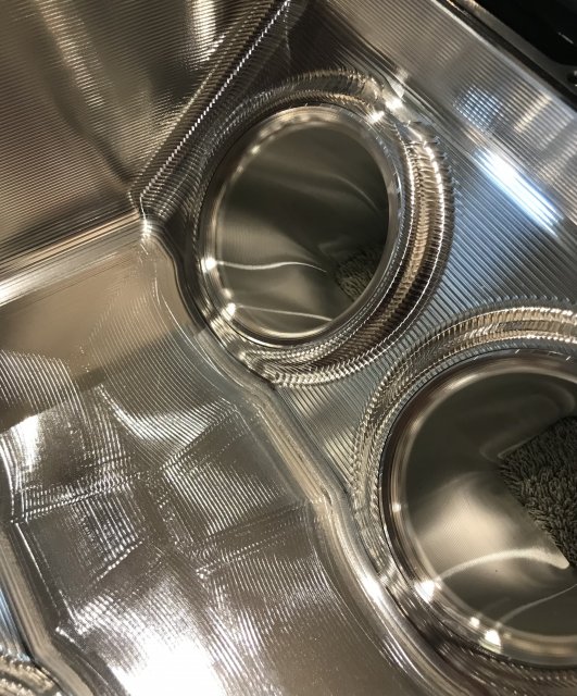

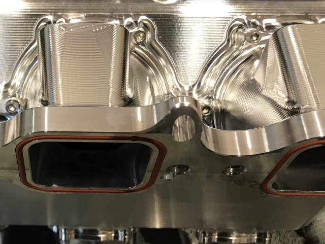

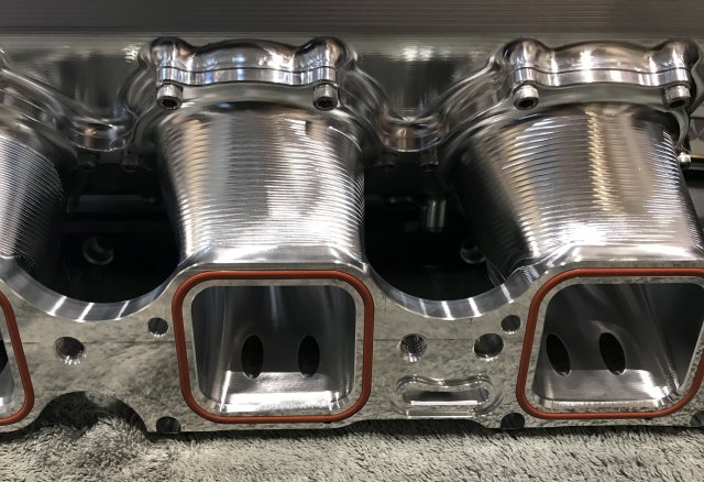

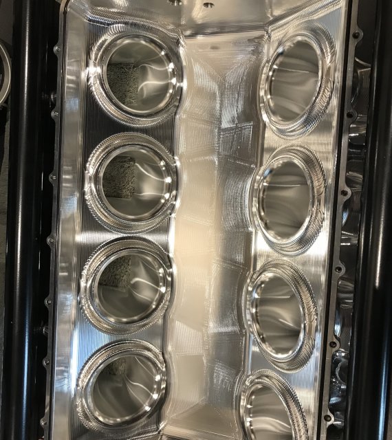

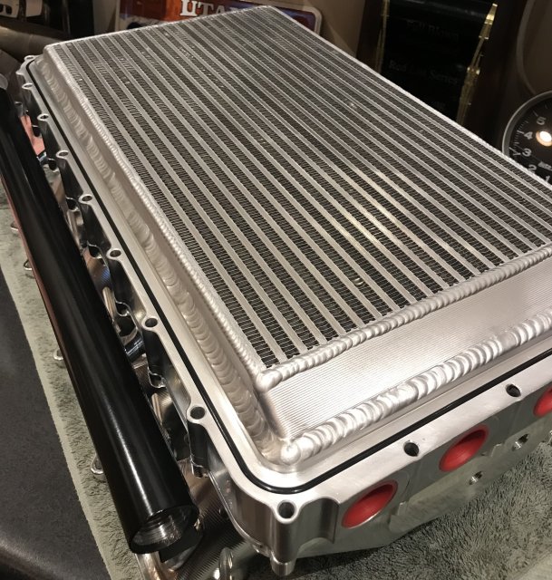

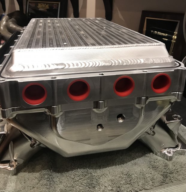

Metal porn 🤤. Thought y’all might like some. I had the time today to take that LME intake apart to check it out up close and personal. Holy Smokes! CNC Billet stuff is always impressive but damn! The intercooler is 16x9 by 3.5” deep 80567A75-930C-40EC-8A57-B3757515049A.jpeg 40D7BA8C-B583-4958-9EF8-58A09311FB57.jpeg 5FEC206F-9543-4085-BF3A-16ED984AF3CE.jpeg 5029C101-8EAE-4A69-BBFE-7C61D46BF65C.jpeg F0C822B1-7FEF-47F2-ADBB-01427AEDF704.jpeg E21CA4ED-CBD8-478D-B1A9-3FDC3DE3C5E1.jpeg D060824D-7858-45D3-8C2A-DA5B51BEC223.jpeg 252FD175-7AD1-41A0-98A9-1F931C522286.jpeg A10B8274-0E54-4B75-8B2F-C88B7AC45722.jpeg

Metal porn 🤤. Thought y’all might like some. I had the time today to take that LME intake apart to check it out up close and personal. Holy Smokes! CNC Billet stuff is always impressive but damn! The intercooler is 16x9 by 3.5” deep View attachment 122222 View attachment 122223 View attachment 122224 View attachment 122225 View attachment 122226 View attachment 122227 View attachment 122228 View attachment 122229 View attachment 122230
O rings on the runners!!!! Automatic winner!!!

I have some bad ideas if I can get the correct IC brick size

When I pulled the intercooler and saw the inside of the plenum and those runners…. My eyes just about exploded. 🤯

So how do the 4 ports work, curious about the plumbing
I assume you mean the in and out ports for the intercooler. 2 in and 2 out. The Whipples have that. A way to increase flow volume. For this…. I’ll be using a big 1” line from the ice tank, splitting it with a Y into 2 in and then the 2 out will be Y’d into the return back to the tank. I know the Whipple DragPak I have now is three separate intercooler bricks. Two going one way and then turning around into the big center one going out. They call it Dual Pass. I don’t know what the internal design of this thing is doing because it looks like one big brick from the outside. The two outside ports are divided from the two center ports that are open to each other. That means that the two outers connect to one and the inners to the other. It’s magic 🤔. I just really took more than a cursory look at this thing today and I’m going to have to talk to them to find out what the internal layout of the intercooler is. Inquiring minds need to know.

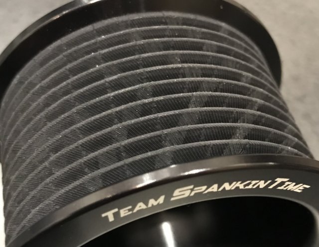

The kitchen sink! 😵‍💫. 7’s 🙏 5D845256-AFA8-4EFB-BC26-CEA024A26EC2.jpeg 37F662C4-3F92-43D9-9DC8-733179273491.jpeg 1034EEAA-51D2-4ADC-9635-142F8DD06333.jpeg

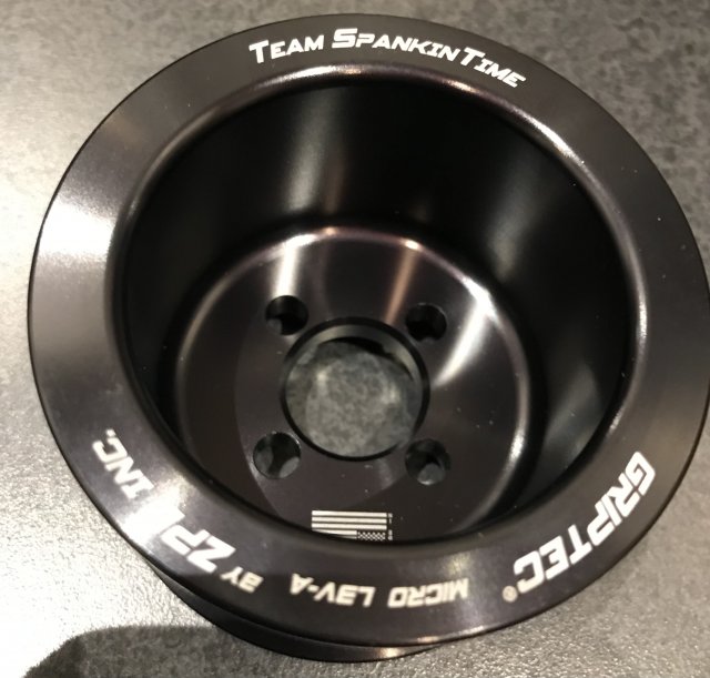

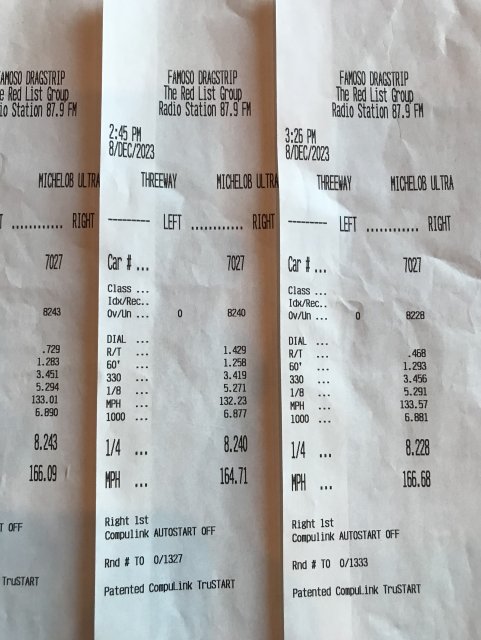

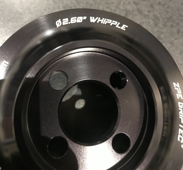

Sevens are hard 🫤. At the Spankintime track rental yesterday. Not quite the results I was dreaming about but fun to be back in the seat again. Had traction issues early with the temps in the 40’s until later in the day when it warmed up a little and the prep started working. Managed a 1.25 with the rears on a 150’ wheelie that would have been the best pass of the day, but….. after a delay that had me shut it down and wait in the box, I forgot to turn the icebox pump back on. I felt the mph go away about 200’ from the stripe. Then… we changed the pulley 😈. Spun the tires in what felt like a slow motion 1.29 sixty after the previous launch and ran a 8.22 at 166.7 mph. The car weighed in at 4100 lbs. So…. That’s it for Blower Stinkeye. I’ll have some good pics later today. AAA484AC-D9E7-46FF-AEBE-5701E5770ACE.jpeg F9CE3EA5-615A-490D-B5F0-8172314CA278.jpeg

does the 3.8 use 4 bolt pulley? My 3.0 uses 5 bolt
Yes the 3.8 uses 5 bolts. I’m was still running the DragPak 3.0 on mine yesterday and it’s 4.
