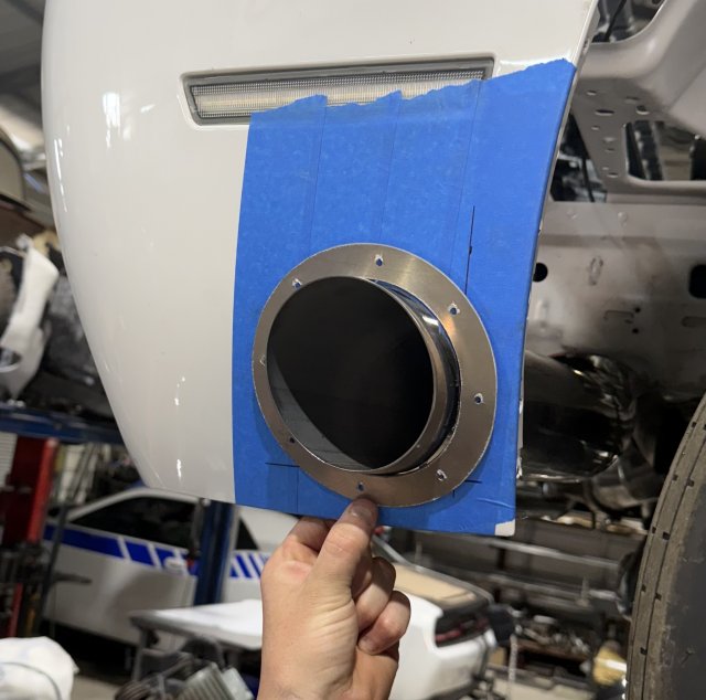

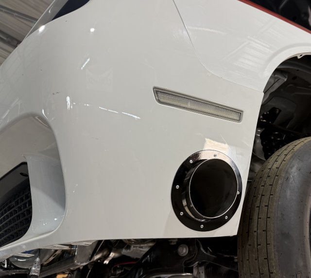

Yep. My own design. I had the Mopar mud flaps before and still got rubber all over the rear. The way the side rolls under behind the tire still exposed the rear quarter. My tires are inside now compared to before but these should work better the way that bottom edge will catch the rubber down low. I think I see a possible offering from Carlin Fab in the works.

pretty cool, different. I like how they look

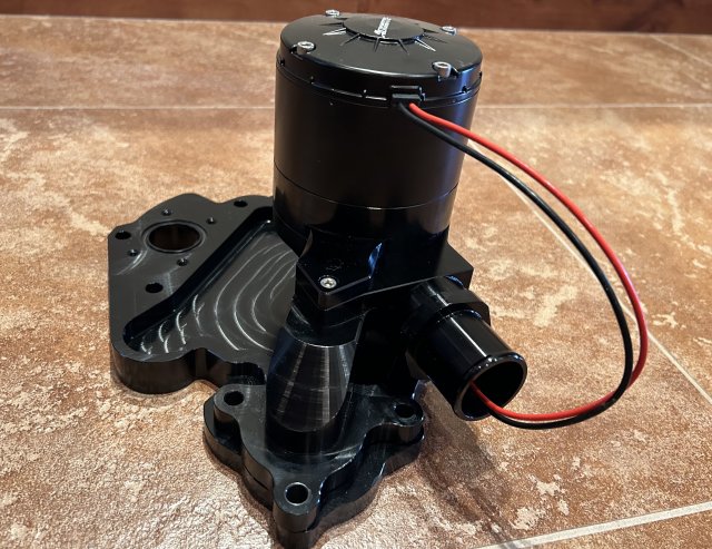

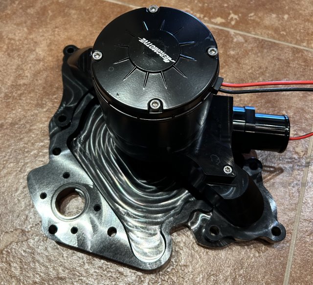

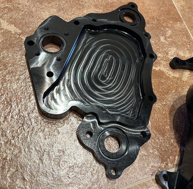

Let’s talk water pumps. This just came out from Aeromotive. A direct mount 50gpm electric pump and plate that is a direct bolt up for the 6.2. Just what serious turbocats needed! 🤩. The aftermarket is catching up big time for us 👊 IMG_7720.jpeg IMG_7719.jpeg IMG_7718.jpeg

Wow, good on Aeromotive! Would have thought Meziere would have struck first - maybe they have - have not looked recently.

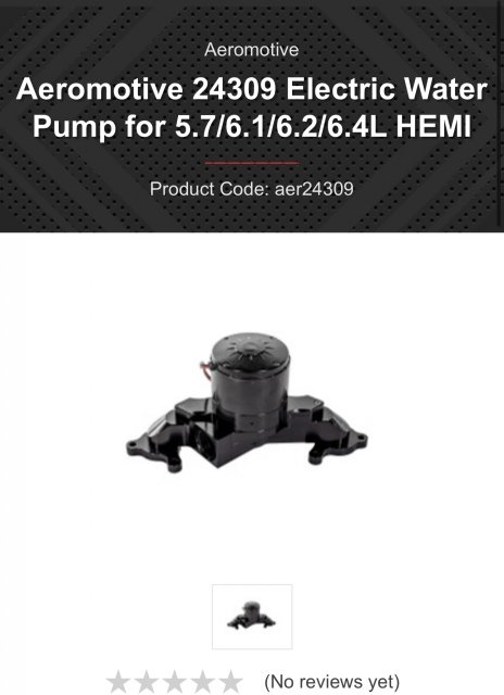

This the one HHP has that fits all Gen 3 hemis?
3,496
11,246
Thread Starter #1,687
The 6.2 is different. Nothing fits all the Hemi's.
7,648
6,438
This must be a different one
7,648
6,438
I don’t see the plate with it, but says it fits all
3,496
11,246
Thread Starter #1,690
It’s the plate that is different. The pump is the same but you have to use the 6.2 specific plate.
