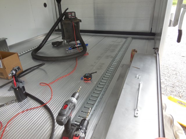

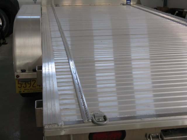

On this trailer there are crossmembers every 12 inches, and the extruded floor panels are fairly stout, too. That allowed me to use two bolts per foot, then rivets in the holes between them. No need for backing plates in this case. DSCN2672.JPG
On this little open trailer I could put bolts every six inches, so it was well secured, but the L-track isn't as strong as E-track. It was okay for the small and light cars I used that trailer for. IMG_4386.JPG

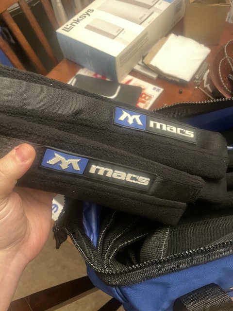

Those sleeves are really to protect the straps. Macs and others sell fuzzy ones (wool like material) that is meant to be kind to the wheels. Which they seem to be. I have yet to see any imperfections afterwards on any wheels.
Those sleeves go on with hook and loop, so easy to put on any kind of straps.
They seem to do a good job on my wheels. Never any marks or scratches, so far anyway.

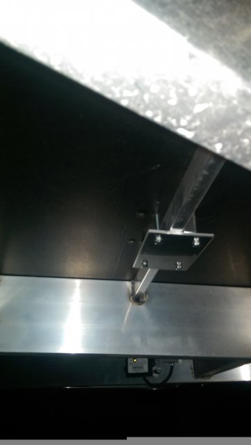

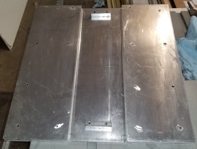

The 1/2" buildup is to clear the cabinet lip. I straddled a support beam under the trailer. So, it's not just bolted to the deck.

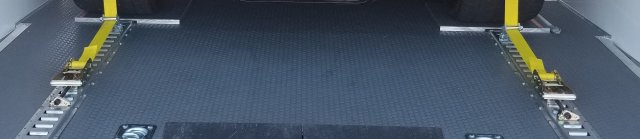

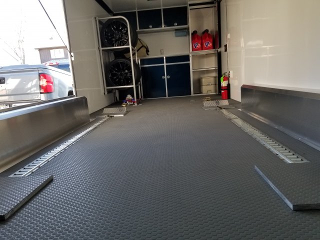

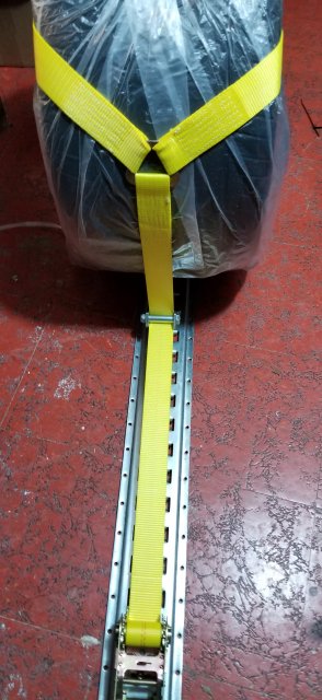

Tire nets are the only way to go. But that's my opinion , the straps are rated at a working limit of 2,500 lbs, I've traveled many miles and the car doesn't move around one bit. The E-trak is anchored through the cross members and also the intermediate anchor points have 6" X 13" X 1/4" plates on the back side of the flooring , if you notice the red headed bolts, they are the ones through the cross members
If you buy the clevises DO NOT BUY ONES MADE IN INDIA OR CHINA. They are known break below the load rating. only buy USA clevises
All bolts used were grade 8 including the 1/2" bolt for the ratchet,
You carry a lot of tires.
Thank you for illustrating what I didn't explain very well.
