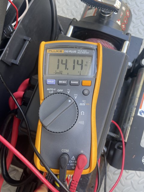

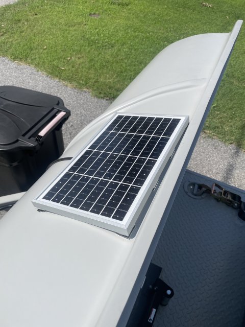

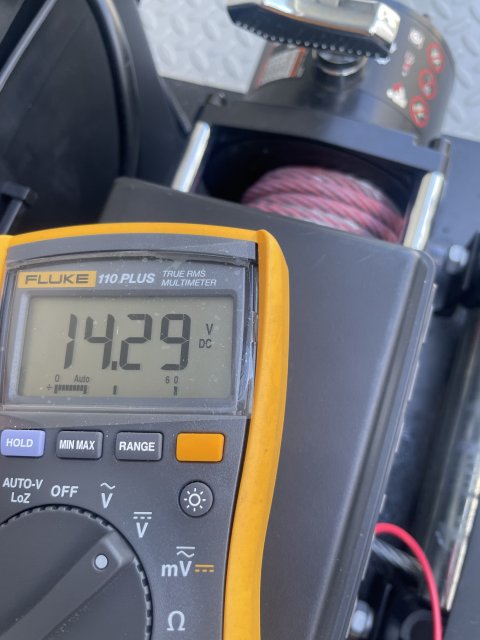

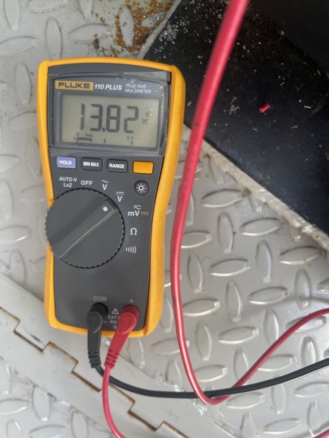

@BULL @Jimmy N. @Unholy707 I apologize, had a wiring issue. Didn't pull enough sheath off when installing in terminals.
power from pv array
power going to battery
battery power
also in direct sunlight
