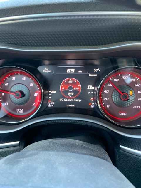

I have some distilled water and water wetter, has anyone switched this out in their killer chiller in their supercharger or should I just experiment and dilute the stock 50/50 mix and to get it to 70/30 with water being the dominant item in the ratio?
6,902
17,809
I've used water wetter in the past and it seemed to leave some silt like residue in the cooling system. I'd go for water mix. Just dont forget and let it freeze in winter. That happened to more than one.

With a chiller, I wouldn’t run water without some sort of coolant mixed in to lower the freeze point.
Here’s why and also note that temps measured at the ICT sensor will be warmer than in the chiller itself.
6,902
17,809
Ah, excellent call, I forgot all about that chiller! Some math for mixtures and freeze points will be needed to find the minimum anti-freeze to water ratio for the temps you see, and I'd obviously error on the conservative side.
Yeah definitely don't want to do that.
Stock system takes 4.5 quarts,1.125 gallons, the BMR tank adds approximately 1.5 gallons. Total 2.625 gallons all together.
1.3125 / 1.3125 is the 50/50 mix. To convert to 70% water 30% coolant as per Kincaids directions I would need to get to: 1.8375 / 0.7875
1.3125 - 0.7875 = .525
So remove approximately half a gallon of coolant and replace with distilled water.
(kincaid's directions for reference: https://killerchiller.com/universal-kc-system)
