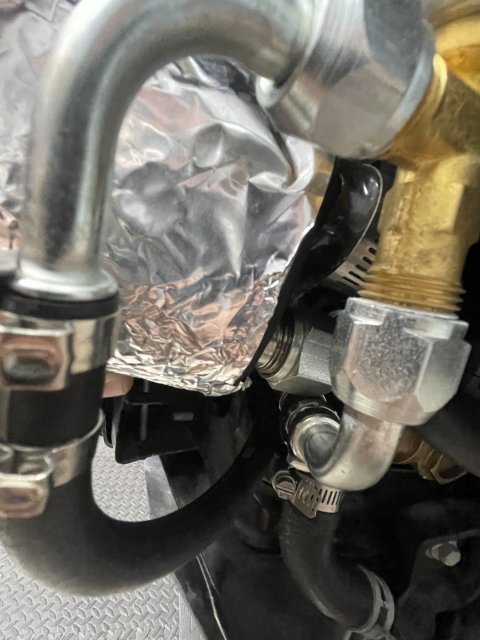

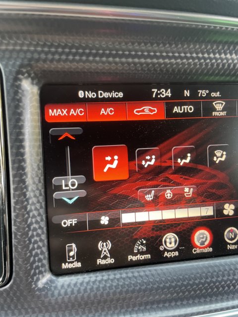

Killer chiller just said fuck you…
38817D6B-26A6-4977-BAC7-325292AF8013.jpeg 746E5940-C7A8-4273-96E2-D9D55DE548A4.jpeg
coolant flows, all valves open or close when commanded, ac blows ice cold when doing cabin…
i think im done, this is a sign to sell the car and get my ass to florida

The unit is not getting cold, however the AC blows stupid cold.

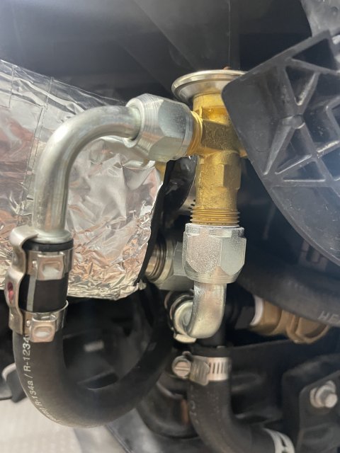

How is the orientation of the unit? Can you post a picture of the Freon in and out lines orientation to the ground? The outlet needs to be on the bottom not the top or it can fill with liquid Freon and not evaporate correctly, worst case not even flow, ie not get cold then.

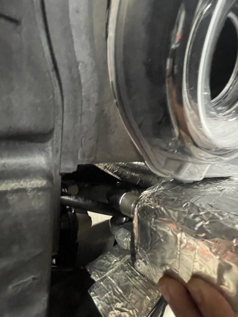

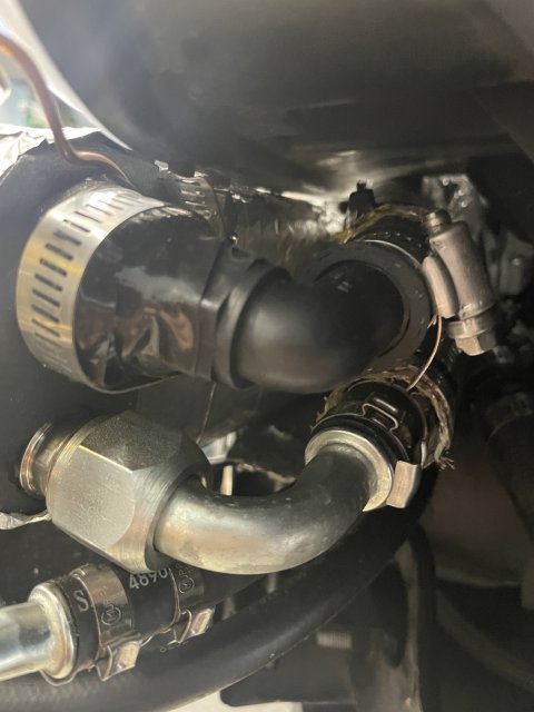

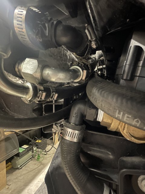

Thread Starter #830
It is oriented down as per Kincaids instructions.
33E1D273-8218-4242-9A1D-CC69F95470D7.jpeg D9F32D88-42E8-4C6D-86A7-4B22CF095666.jpeg B5B2A86F-EF4F-4610-953B-F4AC6AA31313.jpeg
3,467
8,209
Yea, looks right from pictures posted. Does the pipe and hose on the bottom of the TXV valve get cold during operation?
