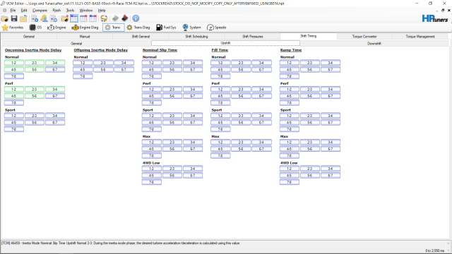

Did you mess with the Nominal Slip Times and Ramp Times at all? I just started messing with those.
I was fighting traction issues my last 2 times to the track I'm guessing my axle was also causing some of these issues and finally just broke the last outing
Doing a compare from stock the values have remained stock.
The inertia mode changes are remnants from Tuners changes.
