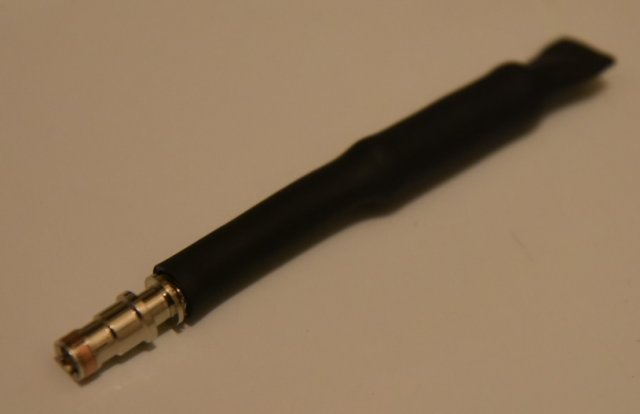

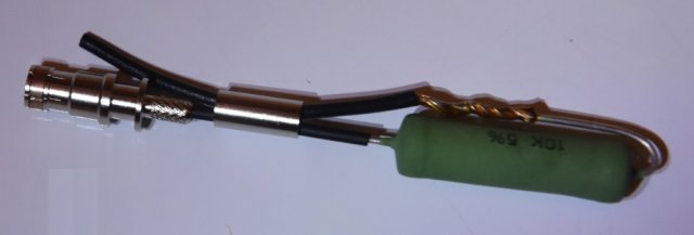

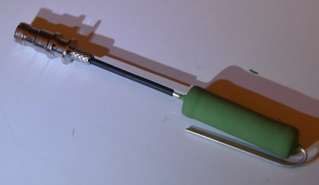

First, quick walkthrough of my process for crafting @Diboblo's blocker. This is needed to explain why mine was acting like an antenna at first:

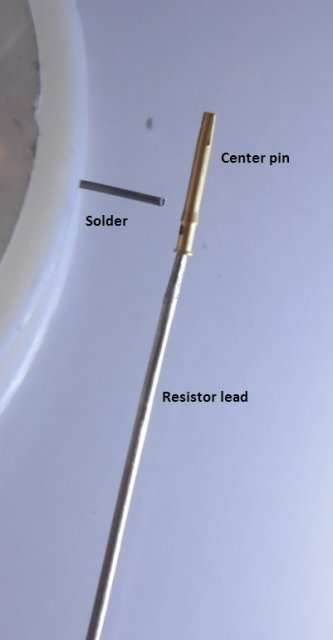

Found that sanding the resistor lead slightly and coating with flux allowed it to slip into the collar of the FAKRA connector's center pin. Solder can be done through the provided tiny hole in the pin if the solder itself is small enough in diameter.
Thin heatshrink used to protect the resistor lead.
Required a small piece of wire to reach from the resistor lead back to the casing. Wrapped/soldered this in place.
Attached other end of wire to plug housing. I also added a full heatshrink wrap of this assembly when finished [NOTE: had to remove this heatshrink later, explanation below.]

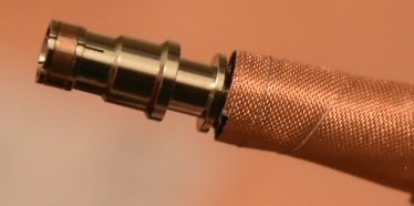

Faraday cloth wrap around interior heatshrink:

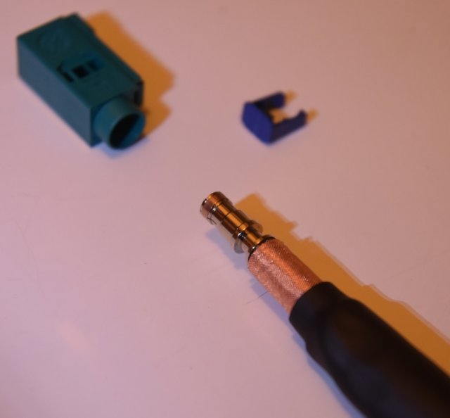

Finally, another heatshrink tube around the whole faraday cloth wrapped assembly, then attached plug housing:
Assembly tested at 10K ohms resistance, as noted above. When attached, the 4G reception improved (compared to no antenna) instead of dropping.
I created a test using a handheld RF spectrum analyzer, which shows frequencies and signal strengths in real time. I found (to my surprise) that if I wrapped the plastic antenna in Faraday cloth, there was virtually no change at all in signals received by the analyzer. If I allowed the wrapped Faraday cloth to touch the brass base of the antenna, it instantly dropped almost all signals to near zero.
Using this information, I then disassembled the cell blocker and removed the inner heatshrink that I had put in. Then I wrapped the resistor/wire assembly directly in the Faraday cloth, and put one heatshrink around all of it (the way @Diboblo described in the original guide). This ensured the copper cloth contacts the plug housing, exactly as it did around the base of the antenna in my test.
Finally, I reattached the reworked device. For a short time (~20 minutes), the 4G reception dropped to zero (no signal)! Unfortunately, then the system regained 4G reception, even with the blocker installed.
Removed the blocker, tested resistance - no shorts, still measures correctly. Ideas/input welcome as to why this seemed to only work temporarily.
