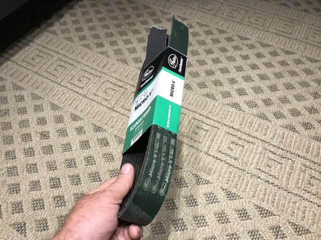

Changed pulley belt. Went out to pick up dinner last night after a good pull through 3 gears lost most power, check engine light came on, went into limp mode. Car had less power than a Yugo. Thank god not far from my house. Able to find correct belt at parts store today. cleaned up running gear on front of engine while belts were off. Replace belt clear code. Test pilot car after. 74 degrees low humidity bout 300‘ elevation. Translation great Da. Surprised belt went @ 16,785 miles, oh well could always be worse things happen. image.jpg

Changed pulley belt. Went out to pick up dinner last night after a good pull through 3 gears lost most power, check engine light came on, went into limp mode. Car had less power than a Yugo. Thank god not far from my house. Able to find correct belt at parts store today. cleaned up running gear on front of engine while belts were off. Replace belt clear code. Test pilot car after. 74 degrees low humidity bout 300‘ elevation. Translation great Da. Surprised belt went @ 16,785 miles, oh well could always be worse things happen. View attachment 112824
It doesn't look like it gave much warning, either to you, or by wearing or shredding, it looks like it just snapped??
That is the issue with the green belts, they are stiffer then the black and they can snap. I only run the standard gates black belt. My Whipple even came with a black belt. I have never snapped a black belt even when we used to tighten them at 150 ft lbs so they wouldn't slip on n 8 rib blower fox body
No no the issue is the black rpm belts
Good heads up, and here I was looking for the green belt because that’s what it came with. Code it set off was P012B
Turbocharger boost control position sensor perform. LOL wish it was compound boost. Basically rotors not spinning and became obstruction probably not pulling enough vacuum with foot off pedal, and then when I stepped into it the 1 to 5 volt feed back on both sensors not changing proportional to expected output. Never noticed but all Three sensors have the same exact Mopar parts # right on all three. Also they say China on them. Would feel better if the said Bosh on them being they are some of the best in the game. Of Course .02
If you are talking about the map sensors there are actually 4 total and yes they say china on them
Actually…. They’re temp sensors 😉
