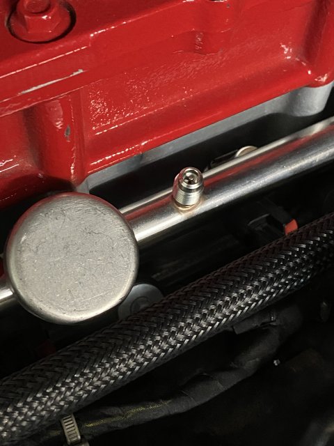

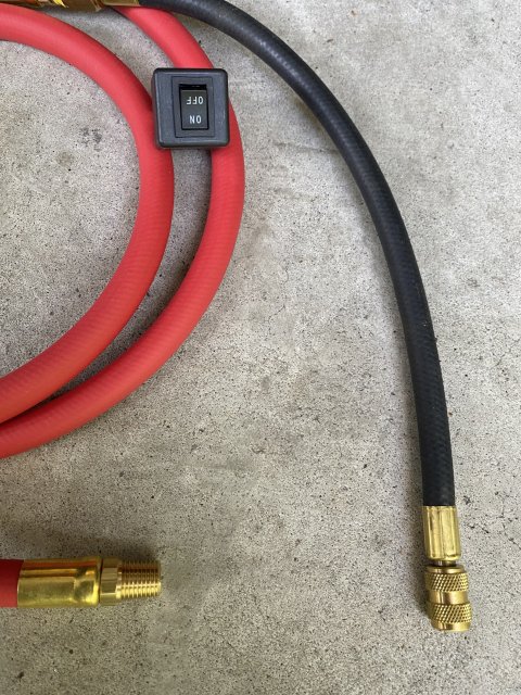

#66
here’s the schrader under the fuel rail cover on driver side, along with the hoses and relay switch. Hook it up, pop in the relay switch, turn it on and it pumps out half a tank a little over five mins or so. 96311DEC-690A-4B5D-B27D-E811DA0382C6.jpeg 581A4F58-98B9-4B1E-9A44-FE8C7DB0FADB.jpeg

#67
here’s the schrader under the fuel rail cover on driver side, along with the hoses and relay switch. Hook it up, pop in the relay switch, turn it on and it pumps out half a tank a little over five mins or so. View attachment 41112 View attachment 41113
Well I'll be damned...
Awesome, and thank you!

#71
It is the same hose assy as the r12 hose from the old AC recharge kit.
