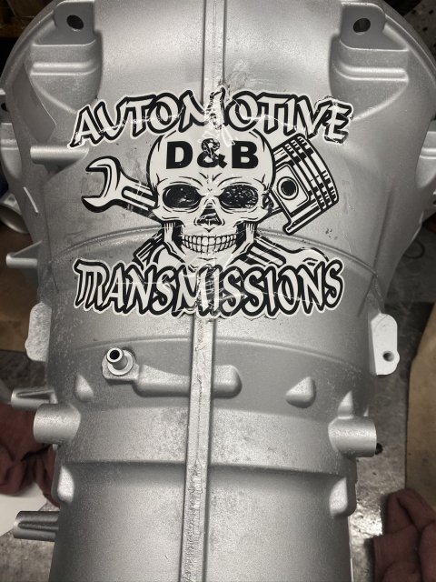

8HPXTREME TRACK TESTED in an 8second car 😁
daaaang let’s go! That things got the sauce
