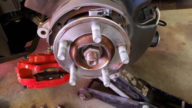

For peer review. Someone said check the brakes. They also mentioned if the axle or diff go the car would not move. Especially if driver side as thats axle gets torque first.

That's not something silly like a pebble knocking around in there is it??

before you condemn the big things a loose wheel flexing will make a snap noise.
check wheel nut torque

Even if its not even "loose," on these cars just not being at 111 because there's brake dust on the mating surfaces can make a terrible racket. Based on what its doing on the car though I'm thinking it is something more serious. When I had that mating surface problem it made a horrendus racket the whole time (getting worse as you drove), not a nice definable "click" like what i heard on the video. Is a suspension component / brake / something else, worked a little loose?

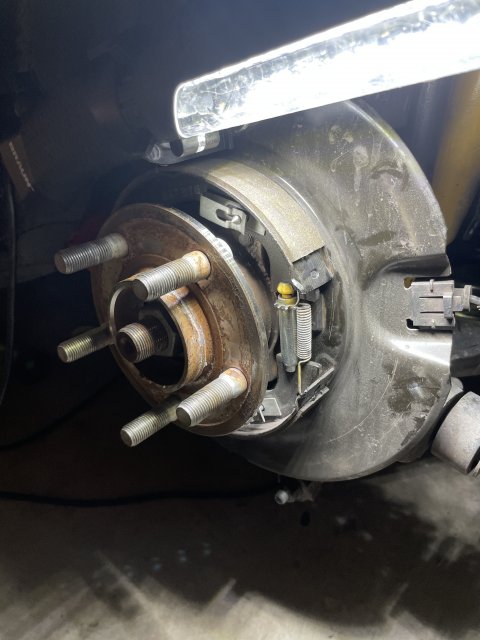

As @BULL said, maybe a pebble or rock. Cleaned out the isolator cups had a ton of rocks in there. Inspected e drum, nothing looks out of the ordinary.

Sorry guy, that axle face is HORRIBLE...
Scotch-brite on a disc...
Or a variety of other similar things...
Not saying it's the problem, but they need some maintenance love...

Thread Starter #30
things that are not on the list of worries… that.
went for a ride, went to the local school lot and did figure 8s. Couldnt get it to happen
going to drain diff and inspect for particulate

Ok, let me rephrase.
"Not saying it's the problem, but its not helping you isolate the issue either."
