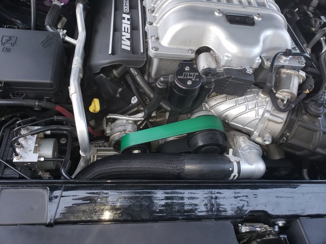

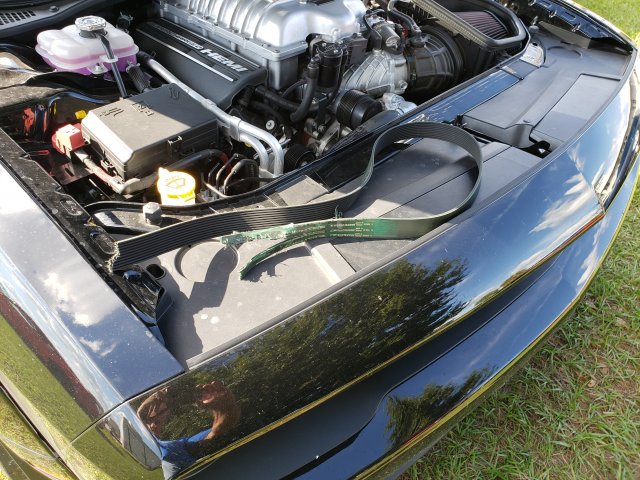

Yes, I got that symbol Saturday at Sebring on track. Fortunately I had planned for this and had the replacement I had with me installed in a jif. Ran fine on track today! My student with his e85 tuned 850RWHP Charger kept getting that and going into limp mode. 20211016_160436.jpg
