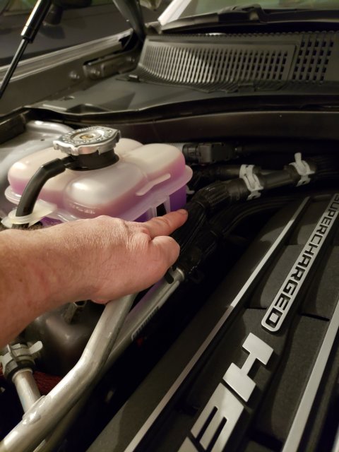

We did mine today and there is a much easier way to get it in. There are 2 hoses that run under the over flow. Get some vise grips and crimp the top hose and take the cap off and let the car run for a bit. You will see the air bubbles come out and you should have the room to get it back in. I lost a little so I topped it off. I did this on Jon car and did it on mine when I put the blower spacers on and today
