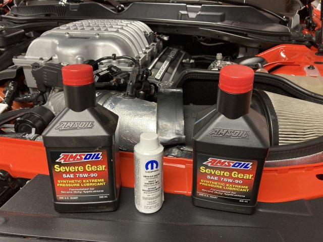

I just got a batch of Diff drain plugs in finally, be fitting them with magnets this weekend and be ready to ship Monday, I may have some Trans plugs too, if you haven’t dumped your Diff fluid yet and want plugs let me know. Trans drain plug not as important as the fill plug being magnetic, it filters out the carbon from the synchros friction pads (there’s metal mixed in it, similar to friction pads in the Diff) from the synchro rings and small bits from the points and gears GREAT, you’d be shocked what the magnet looks like after 3000 miles even. I have a picture of one some where from a 15,000 mile trans, looks like it has a Afro but when wiped off is just a slime but takes the shape of the magnetic field when attached to the magnet, it’s all wear particles but microscopic but does impart wear in bearings and gear faces.
PS, I highly suggest Amsoil Severe Gear 75w90 in the Diff with 1-2 oz of friction modifier, it really is about the best you can buy for street Diffs)

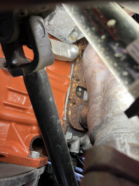

On a side note, look at the flange on this exhaust manifold. It’s like that on both sides and on the unpainted surfaces on the block. It was an East coast car but nothing else on the car is rusted. Normal or are the manifolds leaking at the gasket?

On a side note, look at the flange on this exhaust manifold. It’s like that on both sides and in the unpainted surfaces on the block. It was an East coast car but nothing else on the car is rusted. Normal or are the manifolds leaking at the gasket?
Normal rust on manifold, their 400 series stainless which will rust.
