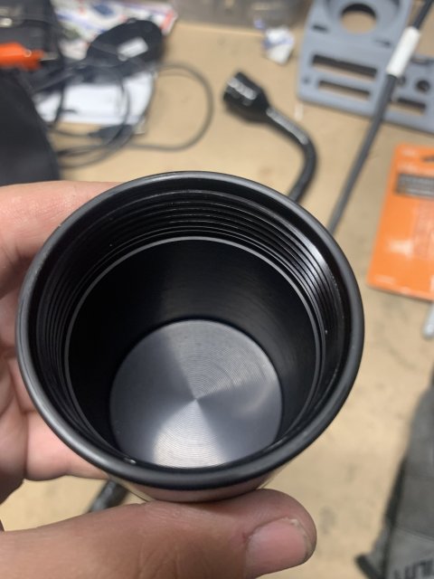

Not to resurrect a potentially dead thread but I just checked my catch can and not a damn thing in it. Stock 6.2. Daily and race it. Taking it off. Also for sanity check blew through the hoses. Nothing blocking in either one.
ng to worry about. You can test to see if your PCV is working at the valve cover but just goes to show you everything is tight and youdon’t really need it on these cars. My 5.7 was way different. It fills up between oil changes.
