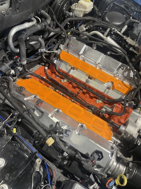

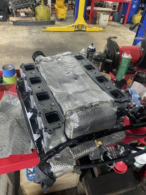

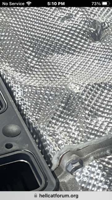

It's hard to tell from this pic if you did it or not, but it's a good idea to cut openings in the blanket where the 2 breathers are on the supercharger.
3,536
8,359
Does not look like it :(
3,536
8,359
@fumanchu182 , need to get them vents open or your going to blow the seals out of your supercharger.
6,885
17,748
YES, just use a sharp object to poke a hole and move the material back around the rounded boss. Easy peasy.

I mean honestly the material is cotton, sure it breaths just fine

Ever remove a glued on blanket? Stuff seals like Flex Tape. Send a blower in for repair with a blower blanket stuck to it and they’ll send it back to you or charge you hundreds to remove it and it’s residue left after pealing it off.
7,597
6,371
Nope, because I’ll never put a blanket on a supercharger. Sold mine, I just use the spacers for sealing

Welp not pulling that blower to make those holes, oh well. I'll deal with that when I deal with that but that blower has been on the car for about a year and some change and hasn't had an issue, with that blanket and yes I have removed a blanket before. Wasnt hard at all. She sounds real healthy!
