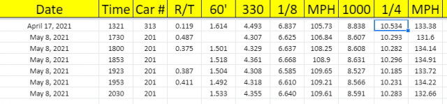

Here's all the data from the races that day. Left a day in from the 17th so people can see how much faster the car is moving. This is due to a TCM tune being tested. If anyone modifies a hellcat and doesnt get a TCM tune done they are doing themselves a disservice.

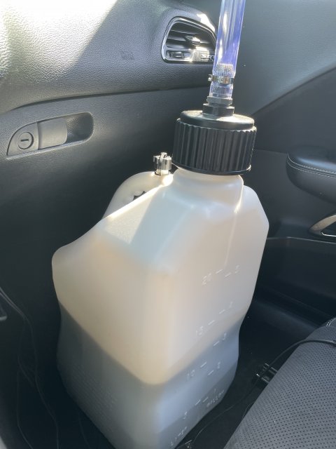

I ommited that I use two gallons of 104 (Sunoco 260 GT plus) with 93 as a preventative for knock. This is the strategy we agreed upon to prevent knock. Sorry for any confusion.

Driving around w that gas container in the car?

Only to the track and back. Never when in and out of town. No where else to put it. Don’t trust it in the trunk (nor does it fit). 🤷🏻‍♂️
