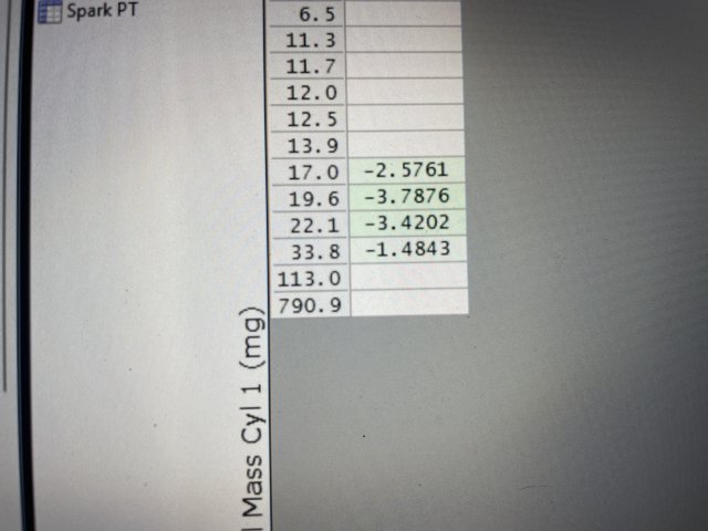

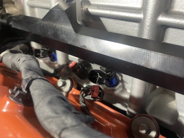

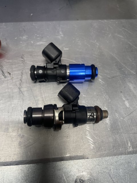

Dropped in some new injectors thanks to @Jon-MooredPerformanceLLC its interesting to see that FIC data uses the whole table where ID does not. The Inj PW vs FM data is wonky but after a couple of idle sessions and some street driving I’m sure it will be fine.

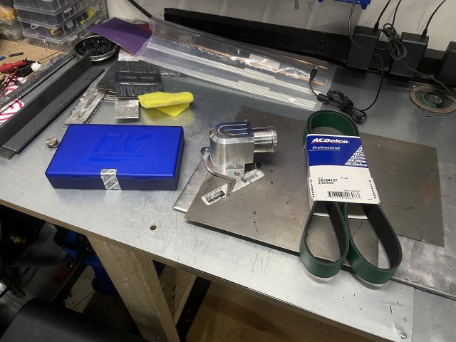

I do have to say I like the construction of the FICs more than the ID, but like the ID data better. Also got a new belt and TBA thermostat housing to put on.
Wanted to do it all today but wound up helping a friend tig weld an exhaust. Anyway if you are in the DMV and need some light welding, hit me up.
initial tune is ready, will follow up again tomorrow

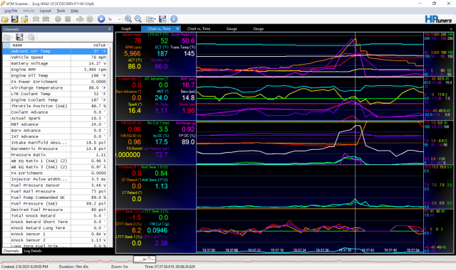

So one of the things I noticed was with one pump on and then not at 5PSI yet with 1650CC injectors.
Pump 1 was screaming. So what I am going to do is switch the triggers. I am going to have 2 and 3 trigger as normal and then pump 1 will trigger when above 5psi. I'm glad I caught this by always reviewing logs.

Yep I hear the injector data is way better with FIC and they idle way better. Never liked my id1300x2s
id data is way better from the factory but once dialed in at idle for sure they are way better than ID's so far, when I go WOT we will see what they bring to the table soon...

This is what I'm trying to prevent. Pump 1 went screaming in duty cycle under 5psi with large injectors, over a year of use of that would be an issue and of course the pump would be burn up because until the other two kick in it's basically sending itself into oblivion.

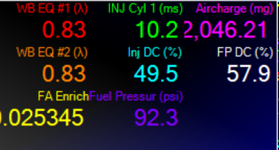

Made my first WOT pass tonight to see how far it can be pushed, saw a healthy 20psi on 2.85 and 10% lower. The other two pumps kicked on instantly so I'm not even worried about it.
She's moving some good air. Best part is, still on stock FIC data for that air. Only lean by about 2%.
Making a small adjustment to enrich the fuel trim and also, racing tomorrow in no-prep 1/8th mile. Just need test data so I figured it's a good time to test the IC chiller, the suspension, new trans.

50 percent duty cycle on the 1650s 🤣 time to push more air. Where is that smaller pulley At?
