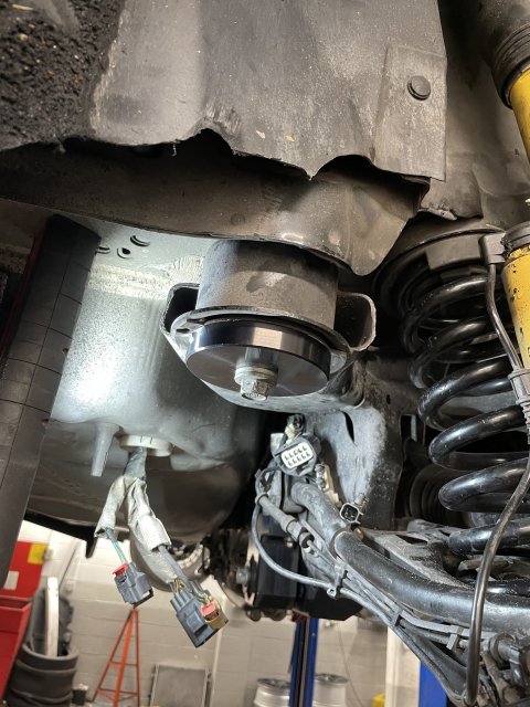

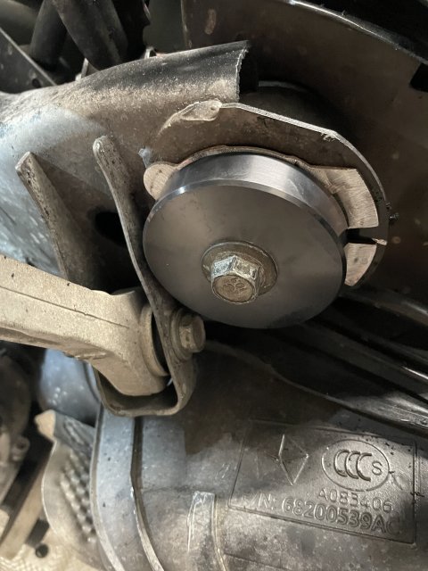

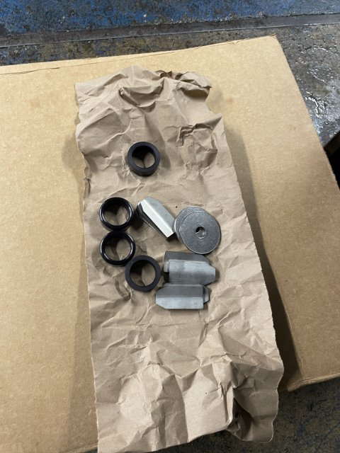

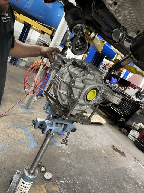

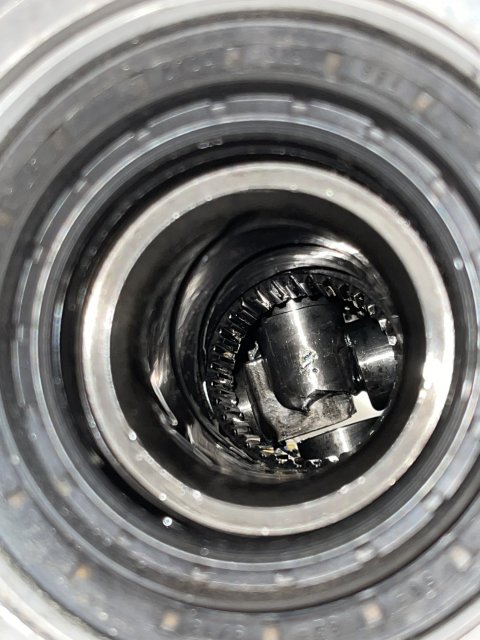

Well guys we fucking sent it. Week after the MHSH finally had a chance to get it on the lift. Well I won with a broken differential.
But thats okay cause the Dr. and I got her fixed asap.
while in there we also dropped the cradle and dis a full lockout kit for the cradle and diff.
bad news still makes the click, trying to source a set of gently used hellcat shocks. We scanned the ADCM module with his witech and nothing was throwing a code. Also need to get isolator cups as mine are pretty worn. Going to make some test hits this weekend at Capitol. We also learned I may have a single digit lineal hellcat
tazer wont remap buttons cause my car was made in 2014, officially they only support cars 2015.5+

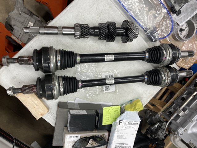

I have a set of Redeye axles with tone rings on them, ready to install, perfect for beating on. I removed them when installing the the new Outlaw axles and new Diff, and new trans too lol. Only known issue was the driver side one had a faint click to it when cornering on the way home from a 5 pass track night that went away after 30-40 miles of road use and 1/4 runs the weeks after until breaking the Tranzilla. $400 for the pair with tone rings on them. Can meet you on 81 with them near the Mason Dixon if you want. Here they are on my cluttered work bench, picture just taken now. They out lasted the 4340 Tranzilla input shaft gear next to them lol!!
View attachment 56768 View attachment 56769
Im worried about that click as im trying to eliminate my clunk, when do you want to meet up? as long as the click is no longer there thats cool.

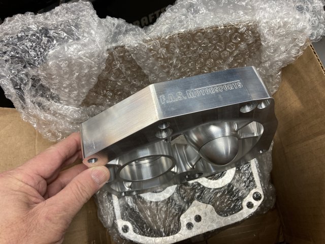

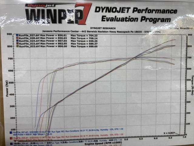

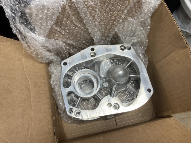

You have a 2.4 blower? Want a dyno proven 50 Hp bolt on? I’m going to be posting this FAS Billet Blower inlet plate for sale. You can’t buy one to self install any longer, this one has had its bores corrected already by me and is ready to bolt on. They sell for $1000 plus installation fees and shipping. Their not hard to do with the right instructions and technique. I’m going to be posting it for $950, any interest let me know you can have first dibs on it. On the dyno chart the upper 2 pulls are with the plate and others before the plate, this on 93 with a 2.85 Litens pulley M6 4th gear pulls. Makes 17.75-18 psi of boost with a 2.85 pulley in good air on a good blower through stock heads and exhaust manifolds.

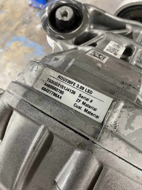

3.09 + RE axles + lockouts, now your talking, SEND IT !
