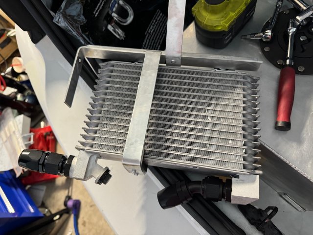

Lots of progress.
Had to seal trans cooler before starting engine, otherwise would spit fluid everywhere.
Transmission Cooler pt. 1
Transmission cooler pt. 2

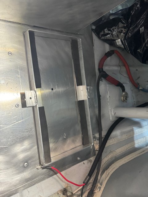

Removed this unusable sensor and added a vacuum line to the master cylinder IMG_3865.jpeg IMG_3867.jpeg
Thoroughly frustrated with Fore. Placed an order and the order wasn't fulfilled till three days later. Shipping wont be here till sept 3rd. 🖕 went on amazon, got copper cable and a circuit breaker (good one). Will be here overnight.
Come hell or high water this car is starting on Monday.

diy bead roller 😭
welded my own battery tray View attachment 144720
Removed this unusable sensor and added a vacuum line to the master cylinder View attachment 144721 View attachment 144722
