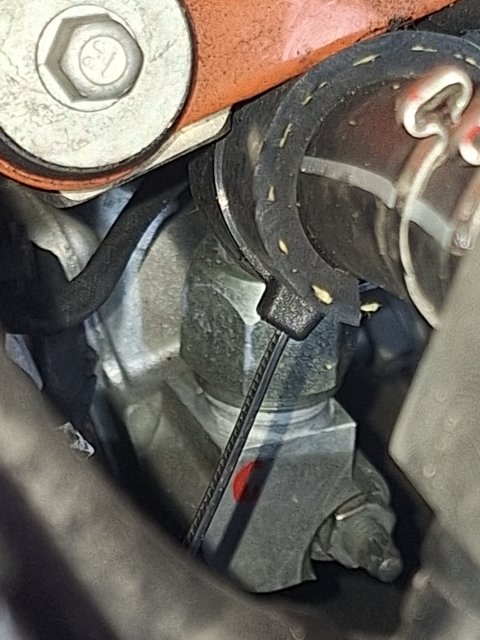

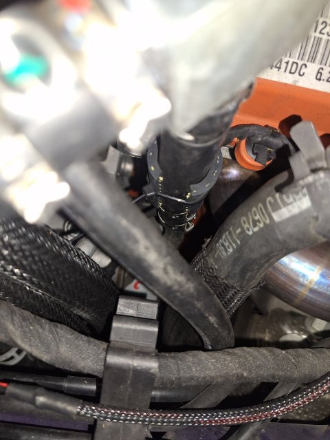

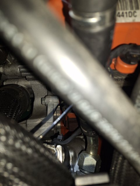

I got some different pictures. My low side hard line is DEFINITELY different that yours. Comes right off the compressor at almost a straight 45* and right into the crimp barb. Yours is longer and with a double bend to clear all that crap. A difference in kit applications or a revision from feedback? I dunno. But I sure could use a new low side port to block to compressor inlet line/clamps with your style hard line.
View attachment 131967 View attachment 131968 View attachment 131969
Weird, must be a revision or something. I’d reach out and see if they have just that part, you don’t need the fitting for the compressor, just the hard line
I'd also need some more of that hose and new clamps. The length from the low side test port to the T block would be too short with a revised hard line if that moved it further towards the front of the car. Also may need to shorten the hose that leads down towards the chiller. Minor stuff really. But yeah. I'll have to contact them at some point this spring. No problems with paying for any additional or updated parts. I just only want to break the system apart one more time before it gets hooked to a machine and deep vac'd/charged properly.
