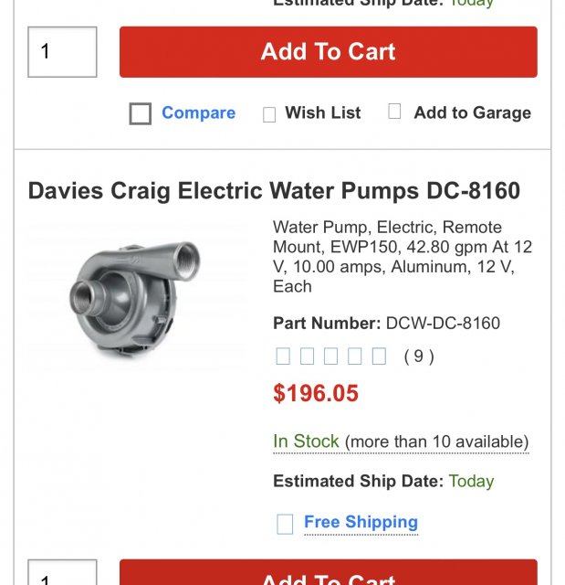

Can someone tell me by the picture what brand and model number that pump is? It has an internal short and I need to order a new one.
7,426
6,146
#57
Yes Davies Craig, pointed that out earlier. It’s a pretty standard pump to use with an ice tank. Just has a custom mount which you can reuse.
7,426
6,146
#58
EWP150. Get the 12v version.
7,426
6,146
#59
Can get it on Summit, they stock them.
