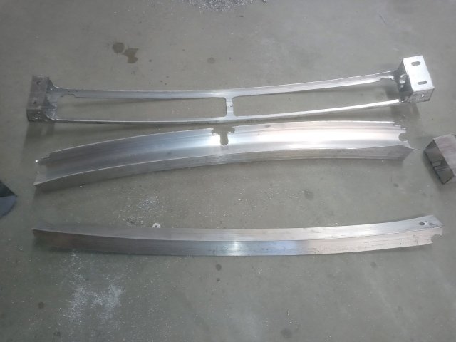

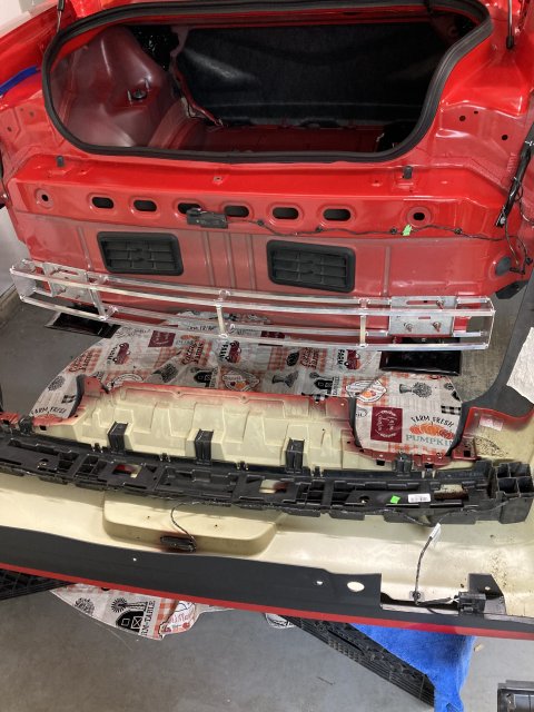

It is aluminum? What was before and after weight? I had been thinking something like this for the front

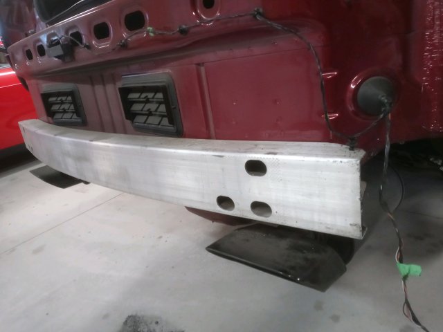

Yes it is aluminum. I am going to say it saves 8.5 pounds. I did not do before and after weights, but I did take the rems to the recycler and he weighed them at 8 pounds even (I did not take everything, only the big pieces).
My Friend that sold me the front bumper support also makes a replacement rear. But he did not have them in stock so I cut down my stock one. This is NOT an option for the front for me since it is steel and it is more intricate and would be much harder to cut.

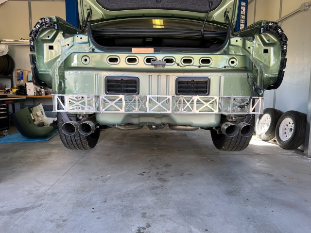

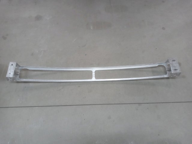

Here is another picture of the front that he makes. It saves 15 pounds. vmacocss05_1292455888616-1-0.jpg

The front is a nice looking peice for nearly $500
Here is another picture of the front that he makes. It saves 15 pounds. View attachment 89645
How did you do the rear?
First thing is you have to have a plan. Then you lay out your cut lines. ANd do not cut randomly or you will be scrapping the piece (unless you can weld aluminum). Sawzall off the ends. Cut round holes at all the corners and this also gives you a place to end your cuts and is stronger with less stress risers. Cut out the front with a saber saw. Cut out an access panel in the rear (needs a shorter blade). Also you have to rough cut access for the dremmel tool to reach in and cut/release that center rib. That is the final piece holding everything together. When that back piece falls out you are left with almost nothing! Shocking........
I used a sawzall, Saber Saw, and 2 different size drill motors and bits. And a nice set of Blair cutters, a die grinder with an aluminum cutter to make everything look nice, etc.....
I am going to do another one in a day or two. If you guys want I will take better pics.
I used a sawsall, Saber Saw, and 2 different size drill motors and bits. And a nice set of Blair cutters, a die grinder with an aluminum cutter to make everything look nice, etc.....

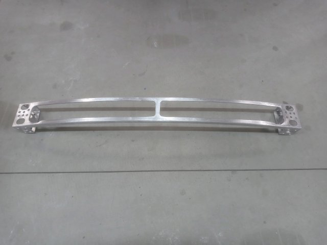

OK, my before weight on my scale is 10.4 pounds. My friend said his weighed 10.5 pounds so they reasonably agree. After was 2.0 pounds. His weighs 2.7 pounds but is WAY stiffer. I pushed down on my car and a car with stock bumper support and could not tell the difference. I don't think outright strength is needed in the back because you do not have the power chiller and oil cooler hanging off the ends like the front does.
Here is a pic of the one he sells on the rear.

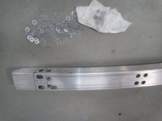

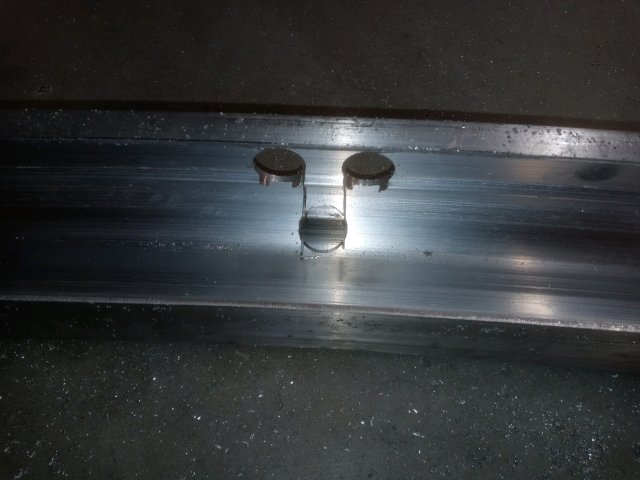

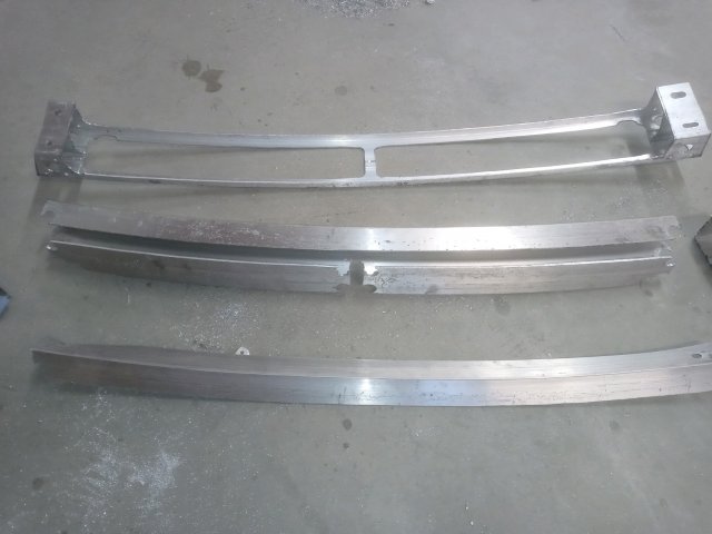

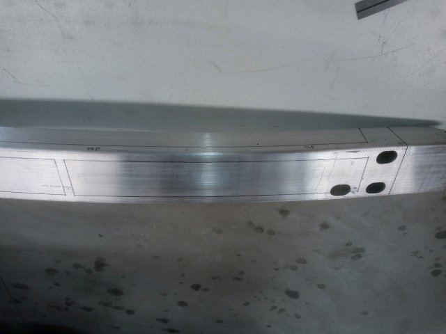

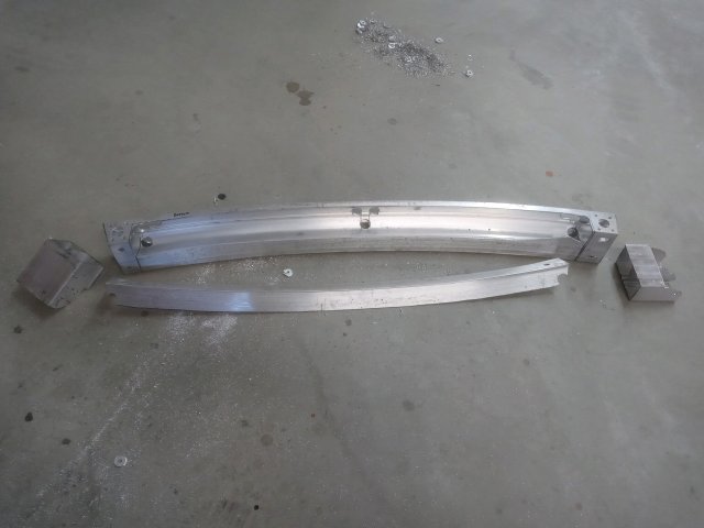

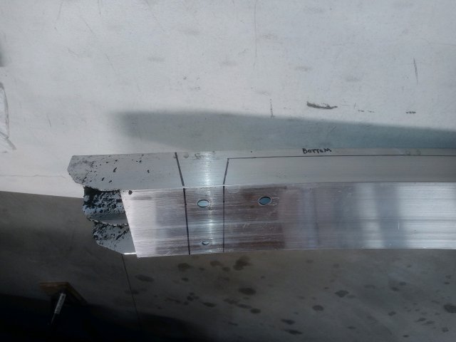

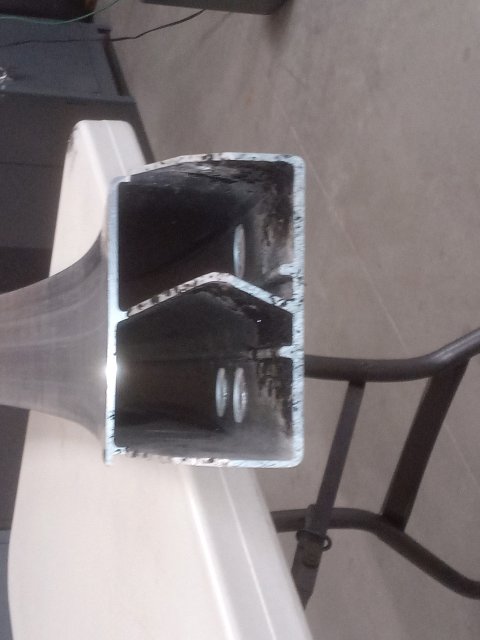

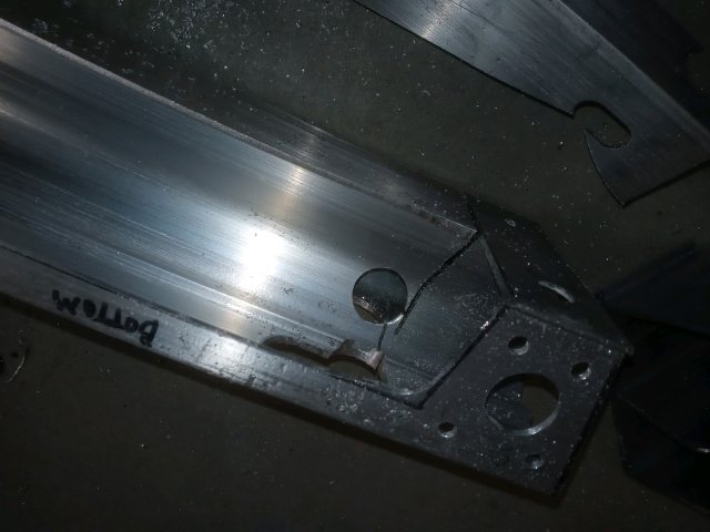

OK the second one I did a nicer job. Of course you learn some things. I drilled and cut some of the lightening holes before cutting the main beam down because once it's all done it is harder to clamp in a vice or hold it still on the floor. I also used a round cutter to intersect my cuts and release the 2 main pieces from each other. That was way easier than a dremmel.
THE END:
THE BEAM: 3.jpg
CUT LINES: 1214220952a.jpg 1214220953.jpg
DRILLED: 1214221338a.jpg
CUT ACCESS TO RELEASE: 1214221436.jpg
FINAL CUTS, YOU CAN ZOOM IN (ABOVE) AND SEE 3 PLACES ROUND INTERSECTING CUTS WERE MADE TO RELEASE THE 2 MAIN PIECES: 1214221444.jpg 1214221444a.jpg 1214221436b.jpg 1214221436d.jpg
ALL DONE MADE NICE: 1214221633.jpg 1214221633a.jpg

Is there a trick to getting the rear bumper cover back on because I have been wrestling with it for a while now. It’s those little tabs on the edge that hold it on that I can’t seem to get back in place.
Yes. On the top corner you need to bring it in from the side. You cannot go straight down. Everywhere else you just slam it on........

Thanks for the help Ron, I figured out the problem was the new aluminum lightweight bumper was not fully seated inside the absorber, so I took everything apart again and repositioned the bumper as high as it could go and it slid right in.

Well, I cut down the stock support so the bumper cover slipped right on. Plus, I cut off the ends and cut off the ends of the absorber as well to match.
Dang it is clean in there. Both these cars have miles on them (11,000, 17,000) and MANY burnouts. So they were filthy and caked on rubber in the outer corners. Probably scraped 1/2 pound of rubber off them both........
All I got to say is "Don't rear end me"!

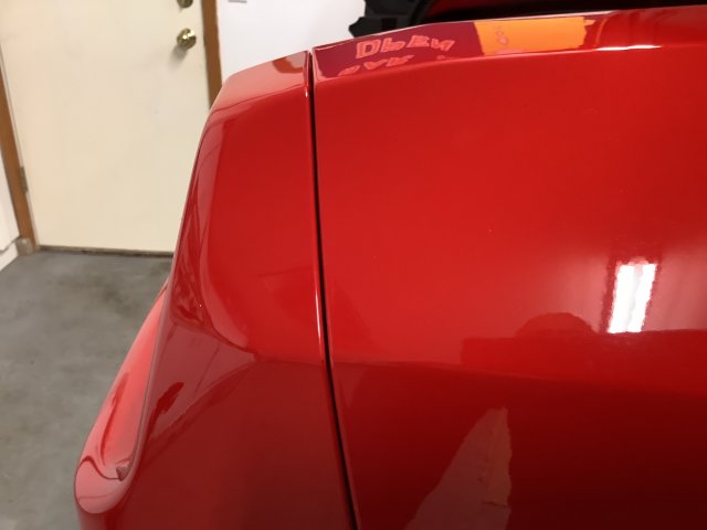

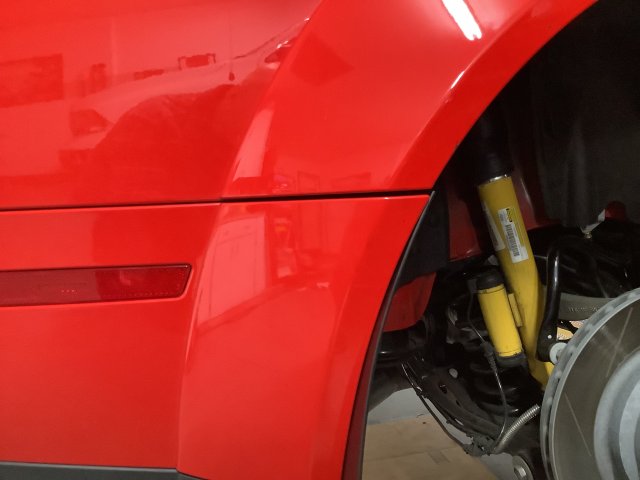

I noticed the gap between the fender flare and the bumper panel seems to be a little bit wider. Probably just my imagination .
DRAGRCR
DRAGRCR
#1181
1,553
5,087
VICTORVILLE
MANGO D170
Thread Starter #496
On my car things are still pretty tight. But on my Friends car the fender flare is not lining up good. I wonder if you pushed up on it before tightening that one screw, under the wheel well liner, if it would close that gap some. I am just too lazy to take it all back apart again. I think yours looks normal.
