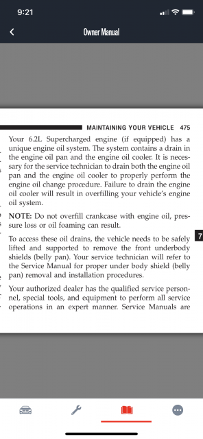

Dealer hasn’t been draining my oil cooler

So on every other oil change you'll have 7.5 quarts of oil in it. The oil cooler should be drained every oil change, my .02

It's about 1/3 qtr. in the oil cooler , just saying it will be more than 7 if you don't drain the cooler.

The Owner’s manual says to do a correct oil change the cooler should be drained each time the oil is changed . It makes no since in my mind to not drain the cooler each time . But to each his own . 86031BAD-5D57-4B42-ADE9-366978F5E36E.png

Don't bring pesky facts into this debate, please.

With the demanded frequency of oil changes (OCI) in these things the matter is relatively benign, especially considering what the TBN (https://www.amsoil.com/newsstand/articles/what-is-total-base-number/), VOA (https://www.bobistheoilguy.com/forums/ubbthreads.php?ubb=showflat&Number=2961485), and UOA (https://www.hellcat.org/threads/engine-oil-analysis.6921/page-2) have shown.
Moot. All moot. Stop trying to find meaningless shit to worry about - just drive your cars and change your oil.
