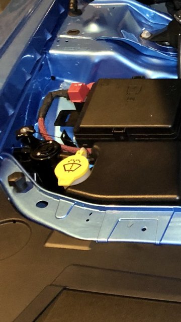

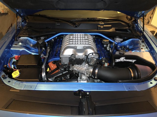

Recently switched from my JLT to a fender mount EBR. Got it for a great price and have heard nothing but good things about them. Too early to tell if it’s taking more oil out of the system however it’s internals are much more sophisticated than the JLT. It also has the one way valve. Looks to be a bit more of a pita to empty but I like that it’s out of the way.
0596A809-189B-45C4-A56F-89C2DF8E093B.jpeg FCFAA1DF-415B-4DE1-AE21-899212D494AD.jpeg

One benefit to that location is not only is the can going to be cooler, but with the longer hose length, the oil vapor will also be cooler, all of which means it will condense and collect better.
(Or at least that's my theory)

Looks good. My concern about fender mounts is the routing of the hoses would seem to create a P-trap. Since no one has reported any problems, it must not be an issue.

Was thinking the same. My nephew has one on his Vette that's Procharged (can't recall the name but it's not the names we see commonly on the Mopars). It's located @same distance as the Mopar fender mounted ones and he says in winter when he drains it he gets mostly water. In summer he gets none. So yes, there has to be a condensation/cooling factor involved. And to @jroyk 's point there could be puddling in the lines imho.
I also remember when I put the Magnuson on my '09 SRT it came with a cowl mount catch can as part of the kit. When you would pop it open it was a 'frothy' kinda gray mess looking crap. Again condensed water mixed with oil. Went to the front motor mount and every time it was drained it looked clean like it came fresh out of the quart.
