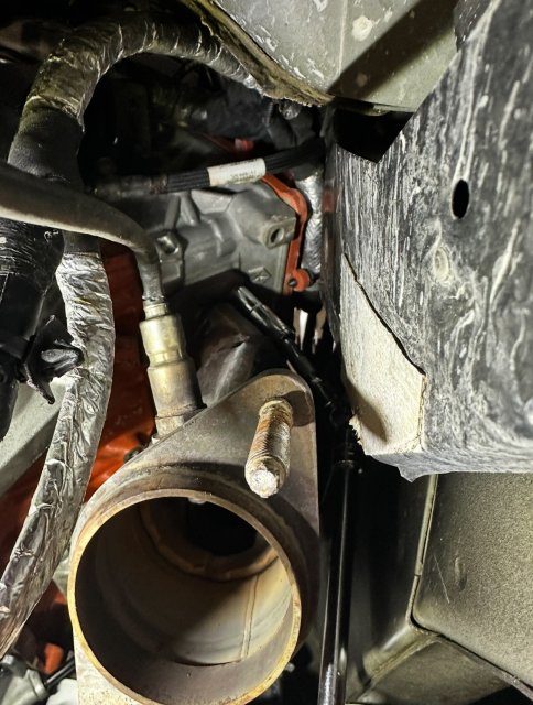

All bottom bolts are relatively “easy” to get to on the bottom passenger side, including the one behind the motor mount, offset boxed combination wrench will make your life easier for breaking them free. Liquid wrench is a must for outside bolts (torqued to heck and all seized for some reason) if your car is “high mileage” (by hellcat standards). Inner bolts are a lot looser and can be done without an oil penetrant

These top 2 middle bolts on the passenger side are a nightmare. Have 1 1/4 of the way out. Last W bolts on passenger side, and then top front 3 on driver side

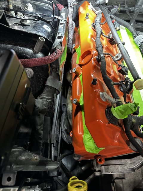

I’m past that, now trying to do top middle bolts on passenger side from the top. The bolts are pointed down on a 45 degree angle with little to no room for the head of a sock wrench because the heat shield for stock headers is right there. Very challenging, used a ton of different combinations and only got 1 of the 2 half way out so far

Flex head king handle socket wrench as well. You need to bend up like a hook to get the bolt

IMG_9441.jpeg This is the space you’re working with after moving that wire harness bundle. Still not enough room to fit a regular size hand down there. No way to get from top on passenger without moving it. Working on last bolt now, much easier than the 2nd bolt from the front up top
