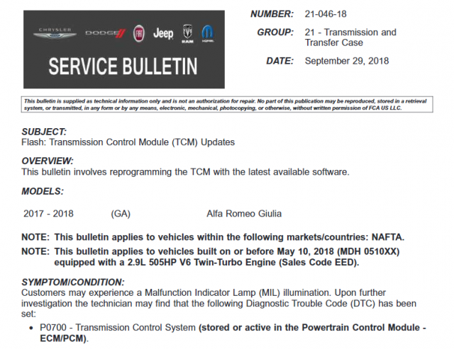

Rob, Can you get us any info on what this update provides, and when it was released?
TRANS:
21-046-18 - Flash: Transmission Control Module (TCM) Updates

@DodgeCares
TRANS:
TIA
es
We are happy to help! I have attached TSB 21-046-18 below.
