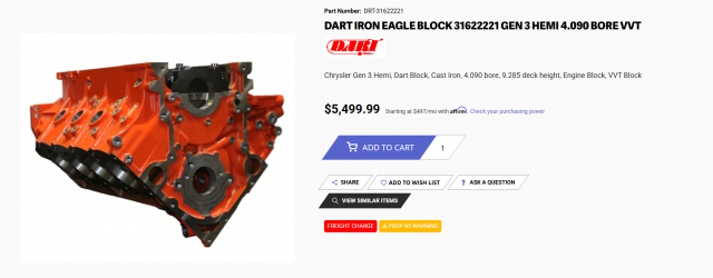

As far as the Dart block...holy cow...I have not seen anyone besides the aluminum blocks say they can make 3,300 horsepower like Dart can and it's a cast-iron block. Plus if we went with an aluminum block, it would exclude us from some events like All Steel All Glass or throw crazy weights on the car.

Jake Sampson and the Dart engineers are discussing if we will or won't fill the block.

That is one of the questions we were wondering. That’s a considerably heavier block and with the 1/2” studs might be safe to run the coolant. Did Dart say 3300? Damn 😳

I was on the fence buying the dart block but it just seems so dam heavy. Why not the TKM block or is that because it will limit ur class racing?

Yes they did and that's why we choose them
The Demon TKM blocks are just the BGE stock block like we have now.
If you're referring to the Noonan aluminum blocks that Demon & Noonan partnered on....oh no, the price compared to a Dart block (6k compared to 17k...not worth it) and then aluminum blocks are not allowed in some classes
