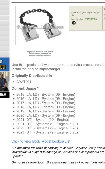

I have the mopar tool to lift the supercharger off via an engine hoist. I’m wondering if the engine can be supported by the supercharger. Thoughts? Not lifting the engine and transmission out of the car, but supporting it for removing engine mounts

The tool clamps onto the sides of the supercharger, so theoretically most of the load would be on the bolts to the head

This is what I have. They say engine supercharger, but what they really mean is engine AND supercharger
