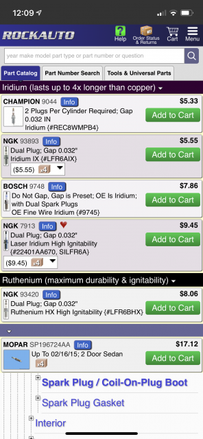

I havent changed spark plugs once myself in the car and since I bought it used who knows whats going on in there. This weekends activities include compression check, borescope images and inspecting the knock sensors. I’d like to add changing the plugs. Im currently running a 2.72 and have read on the old forums that 0.028 is recommended for cars up to 18psi. Here are my options on rockauto:
Can anyone speak to the items in this list or recommend another brand or one step cooler?

The .028 gap sounds good, but I think I would use factory plugs, I have never checked mine or changed either at 10k now, I was told their good till about 50k, on a 100k plug. But if I was taking them out in your case, I would go ahead & change too.
4,981
9,438
I think the stock plug is Bosch R6, double check that tho.

NGK 2309 should be one step colder.
And, yes, its a PITA on the hellcats due to the intercooler coolant lines and valve covers
