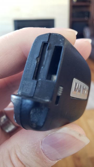

Walking back to car from my kids event, fob completely dead. Luckily opening driver's door connected again. Coming up on 3 years so I decided to change all 3. Hardest fobs I have ever changed. Used a plastic razor blade to get fob separation started then followed by a small screw driver for the rest. Minor scratch on black fob (who cares) as screw driver is too harsh to get separation started. Hope this helps...

When you pull out the physical key there is a groove in the fob so you can use the key to pry it open.
One thing I have found with older fobs is pulling up on the prongs inside gently. Helps to ensure the fob will work properly after the battery change. I have had a few that I needed to squeeze the fob so the buttons would work periodically.

Mine were sealed shut. Emergency Key wasn't doing it, but maybe I gave up too soon. Good info moparjim. Thanks.

As stated above, no need to mar up the fob. Just remove the spare key and pry up on a tab that's there specifically for that.

A credit card does wonders :)

There is a dedicated notch for separating the two halves once you remove the manual key...

It's good to have a dedicated notch.
