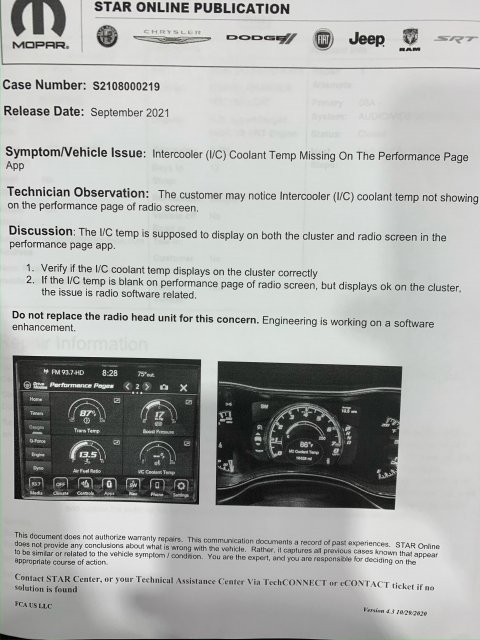

Thread Starter #13
Guy that follows my channel sent me this. Looks like there's a TSB for this IC Coolant Temp problem. Anyone that swaps their unit whether new or old will likely have this problem.
15,546
48,454
Bummer about the Intercooler Coolant Temp not working, it is one of the issues with the '16's (the IC intake & coolant values swapped) I would have expected this to address since the software is different/updated.

At least they are acknowledging there is an issue this time !! When their crappy update broke the gauges on our '16's, no one would own up to it and it was never corrected.
I'd bet real $$ this will never get fixed either, look how long this TSB has been banging around ! All they are doing here is covering their asses so dealers don't try to do expensive radio swaps to cure the issue for those still under warranty IMO.

I sent the TSB to Speedy today. I had my infotainment unit switched out under warranty 11/21 due to delimitation of its screen. Everything, including all gauges worked without issue prior to the swap. Prior to leaving the dealership my Technician, who is also a friend, noted that the I/C Coolant Temp wasn't displaying on the screen, but should load after a bit of driving. I gave it a few weeks for it to resolve on itself without success. Took it over to see my Tech who tried multiple times to reset also without success. He later searched and found the TSB I sent to Speedy. Still, nearly two years later there is no fix available. If, and when, I ever hear of one I will post an update.

Thanks a ton for sending that over. Cleared up the question fo sho.

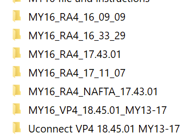

Well as it turns out, I am NOT current, I don't recall my exact reason for discontinuing the updates, it may have in fact been this issue, I think it was also related to unsubstantiated reports of the update associated with the original exhaust cat recall/update that some said robbed power.
But, at least for the moment, my gauges are correct/matching between the radio and the driver's display.
Ref: currently running 17.11.07
(Known releases in my archive)
