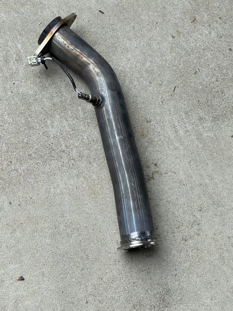

Only issue I continue to have is the P0420 and/or P0430 codes. The dealer changed the exhaust from the header outlet to the rear bumper, and all the sensors twice. Going back this week. Weird thing is it doesn't throw the code on track, but usually Sunday afternoon after track is done and driving home, or later. I broke the first green belt at 16000 miles, on track. About the same miles on this one, so I plan to change it before the next Sebring weekend 14-15 OCT 23.
@Jon-MooredPerformanceLLC plus…..
Makes that damn problem go away. Also mine now wears a black belt and I am not going back to green shit. Glad you went back to MO! I’ll be back, just working and traveling a bit too much right now.

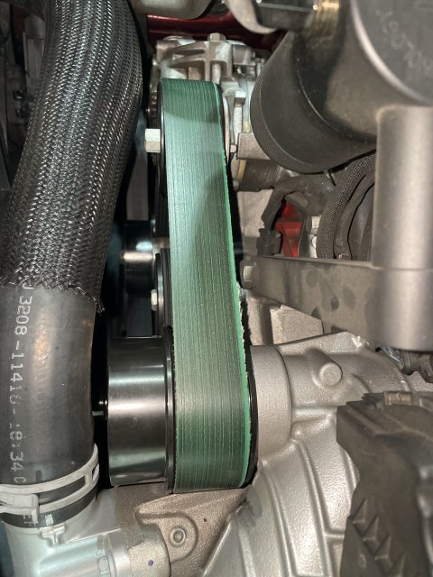

The gates green belts are a common failure point? I thought those were supposedly considered an upgrade.
6,935
44,237
Upgrade? We all may have a different opinion on that. After about 10k miles and a few road courses and a lot of RPM cycles and 6250-6500 shifts?
I have seen my 2015 Hellcat a buddy owns after twice as many miles. The original black belt looks the same as new now! I changed to black and it runs and sounds just fine. I’ll keep a new green spare in the tool box and hope to never need it.

Interesting. Good to know--so the Bando belts hold up better than the Gates green belts. Wonder how the Gates "RPM" belts fare.
My Redeye green belt is looking rough after a few track days. Which belt do you recommend for stock Redeye pulleys?
6,935
44,237
Thread Starter #19
IDK, but I don’t like the green one. That 2015 I had has run many laps and its’ belt looks fineat 20k miles. That green one has barely 10k miles. I say a half dozen weekends. Not enough to look like that. Different supercharger. 2015 Hellcat and a ‘19 RE.
Oh and I do have stock pulleys. Tuned. Occasionally it just shifts a bit high If I hold my foot in it.
