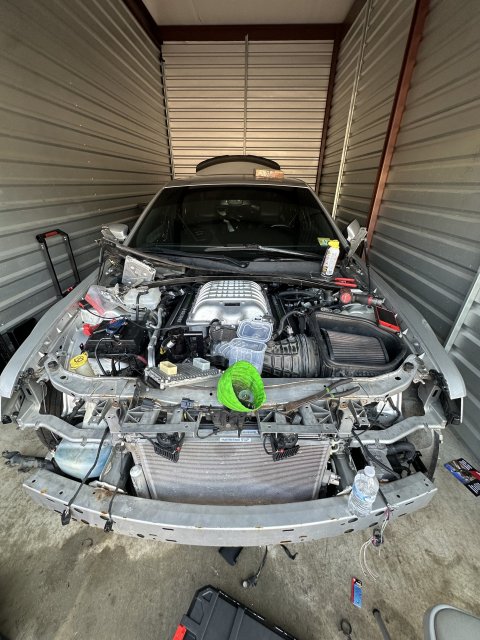

So I purchased a redeye swap originally through eBay was listed for 21k seller wound up canceling the order and refunding my mo ye cause he was so called an aware of eBay taxing system to seller and buyer wich I did not care he clearly did so I flew out to Texas and bought the entire swap and has a car hauling service tow it back to my home state I swapped everything from a 2022 hellcat redeye charger to my 2012 Chrysler 300 “srt8” original chasi now everything went smoothly until we got to the computer part and the programming it seems the seller was a bit of a sticky hand man and couldn’t just send the honest computer so we noticed the RF hub the swap came with was to a differnt car so I called dealer and purchase a brand new RF hub the car/swap came with 3 keys 1 redeye red key 1 redeye black key all oem and strange part came with a black srt key now we tried programming all 3 keys swap came with even tried programming a whole another key to another redeye hellcat my friend owns nothing can anyone give me insight please what to try next only reason I’m not thinking dealership cause they might look at me like I’m crazy tryna bring in a 2022 Chrysler srt8 hellcat redeye 😂 😂 😂 knowing it’s original warranty’s clearly voided ect another important question what is everything computer in the car that I would need to purchase brand new to make this bassicly a brand new system so I won’t have any problems programming a new or my OEM exsisting keys and just want to say I’m new as member here but always read your forums when i have a basic question but unfortunately this isn’t basic I have about 50k into this swap and need to get to the bottom of it before spending anymore money considering idk if the motor will start or not old previous owner states the swaps been pulled and sat in his garage for a whole year in parts so maybe was thinking that’s why the keys aren’t programmed anymore to the pcm can anyone please help me asap thanks everyone and drive safely IMG_9838.jpeg IMG_9307.png IMG_2583.jpeg IMG_6443.jpeg IMG_3623.jpeg

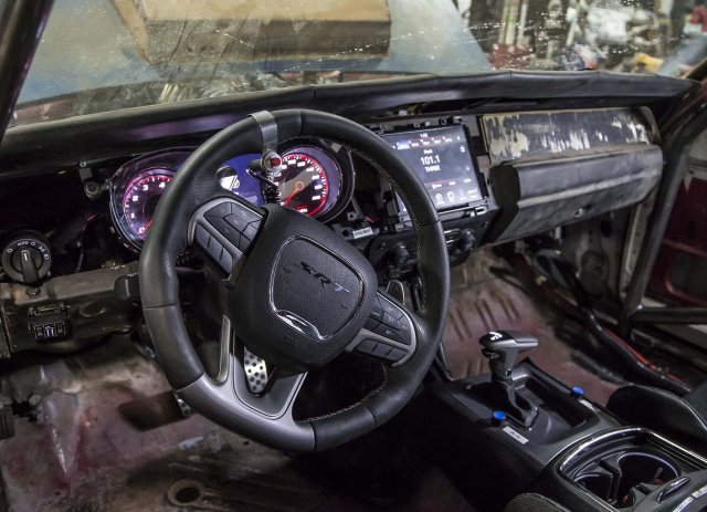

Look at the Roadkill 68 Charger - swapping in a Hellcat...
I looked at everything they had to swap to get it to work...
