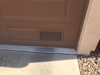

No question. An insulated door will be better than a non-insulated door. I have seen small screened louver’s installed in the bottom of a door. Maybe you could insulate it and use a floor fan to exhaust the hot air with those kind of louvers in the door...

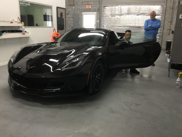

I would pick up a couple of sheets of the foam / aluminum sandwich stuff at Home Depot....try it. I did the bubble wrap on this roll up door at my kids tint shop It helps
