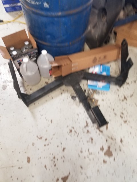

Here’s a photo of the hitch itself (sorry for the poor quality). I also had a 10,000 lbs rated S on it (to raise the winch to a usable height) secured with a solid carbon steel locking pin. When I pulled on the pin I found it had broken the locking mechanism cleanly (could not tell it had happened) and put a big bite into that tool steel. I still don't understand clearly how it was able to bend without damaging the frame. The hardware all appears to be good. I'm going to go over it further next week.
