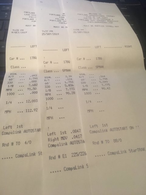

I ran my NTO5's at 16 psi but I was only giving them a light fuzz in the burnout box.
I had mixed results and this may have been because I wasn't warming them up enough.
