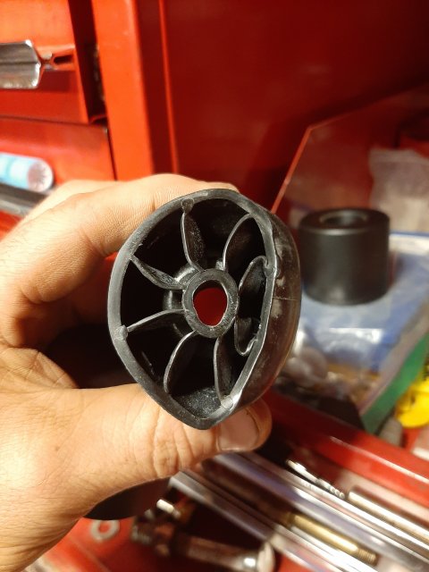

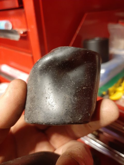

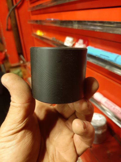

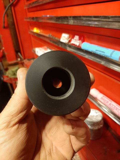

Bigger thanks to Lift Pad Pros for the HD Delrin replacements.
Some may view them as pricey for 37 bucks shipped but after a cursory Google search they're about all that comes up. They look to be worth it though. Mine took a dump as you can see and I'll only have my jack on drag week since I'm not taking the quickjacks. With that many tire swaps in 5 days I'll definitely have a followup opinion on these.

Yeah. Thanks FCA.
View attachment 113249 View attachment 113250
I like it, however I would like to see a bigger chamfer or radius on the bottom.
If mine ever give up I'll try to remember these.
BTW, Delrin isn't cheap so keep that in mind.
