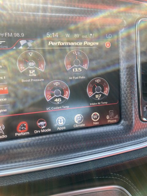

You’re just getting the sputter out of nowhere or what?

Thread Starter #18
When the chiller is on and it’s cold like that cruising on the highway,that’s why I believe it’s the condensation in the supercharger causing it to sputter
