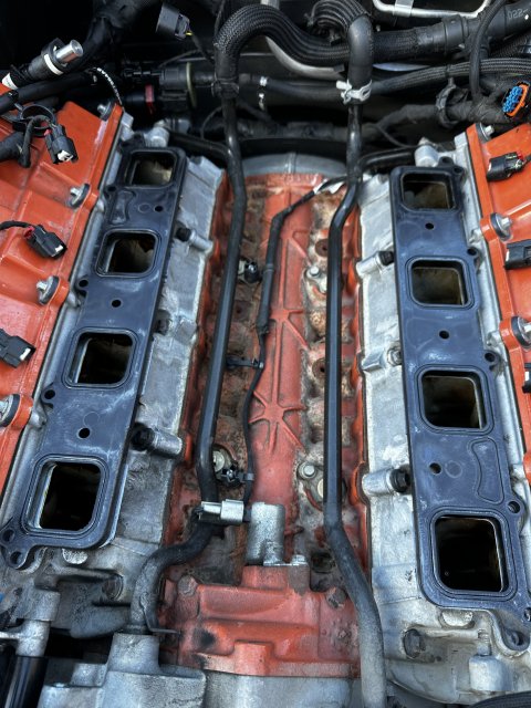

Welp valley needs a repaint. Still getting ton of blow by

It’s been like that practically since new, hasn’t really gotten worse. 2015 engine block paint was horrible

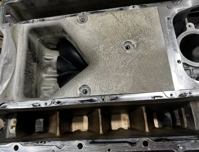

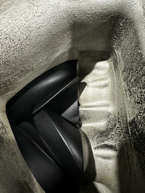

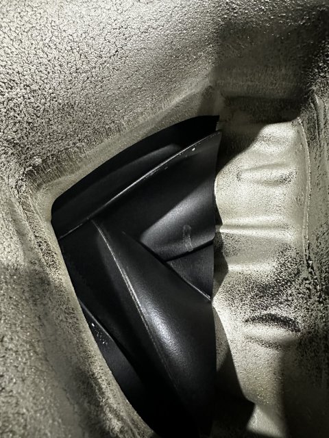

Rotors overall in very good shape. Only a little of the sacrificial coating gone

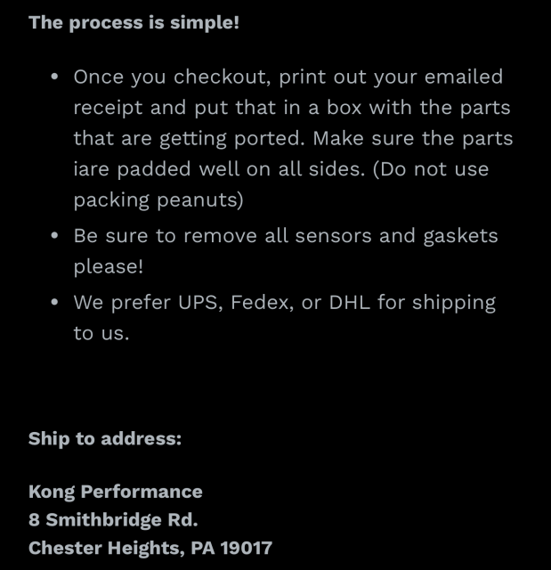

@fumanchu182, what all did you take off of your blower to ship for porting? Did you take off the bracket for the bypass valve? What about pulley, about, did you take about apart to remove snout gasket and pulley/hub?

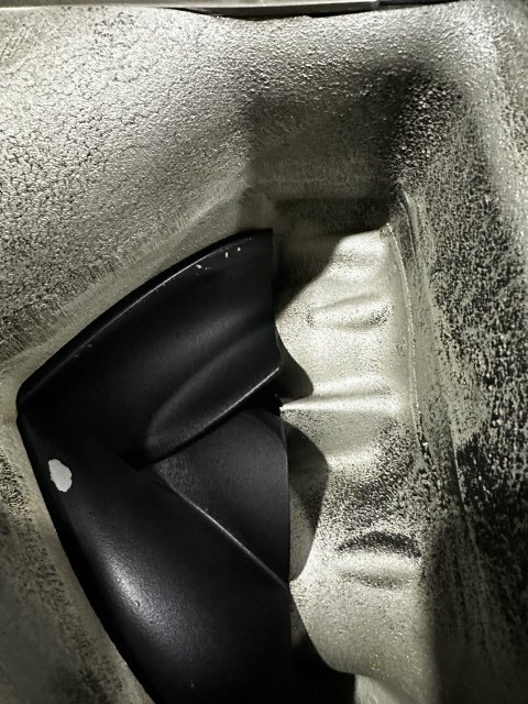

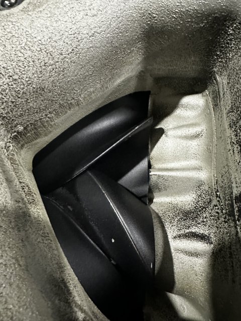

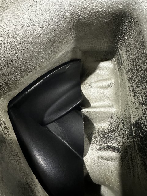

This is why 2018s have better airflow characteristics than 15-17. 18s also have thinner legs on the bearing plate

Blowby issues will be fixed by switching to the URP breather that caps off all ports to the blower from the valve covers
All of this is on Kong’s website or you can call them. Lid does not need to be sent. Remove pulley, gaskets don’t need to go either. Id call them if you have Q’s, I got mine done years ago and don't remember it all.

It’s on its way to Kong for a full max effort port and race bearing rebuild. Didn’t need it. Where the coating is missing the roots still have their machined finish, I don’t think there was any contact. It’s a relatively low mileage blower. Also no bearing noise, just getting the rebuild so I can spin it a bit more and not worry about it (besides the heat)

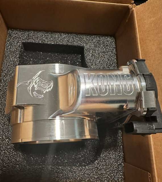

Thread Starter #17
Crazy how much bigger this is than stock. It’s $200 more than the regular 108mm nick Williams throttle body but worth it. Its machined for an o ring on the other side. 108mm throttle body gaskets are $40 a piece and always on back order. SDG was my first choice, but got the throttle body, full race bearing rebuild (snout snd bearing plate, sdg does not replace bearing plate bearings), and max effort port job for less than the price of just the bearing plate and snout from sdg (including shipping). So we’ll see how it works out. If there’s damage I’m sure Kong will let me know. Do you still have the pics of how bad your 2.7 was @Speedy! IMG_8983.jpeg
