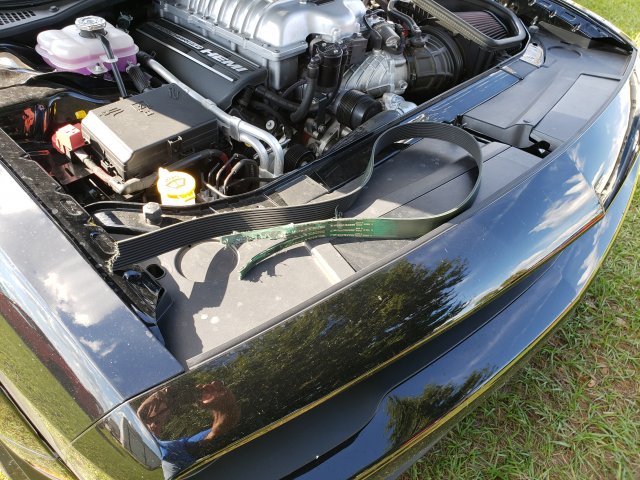

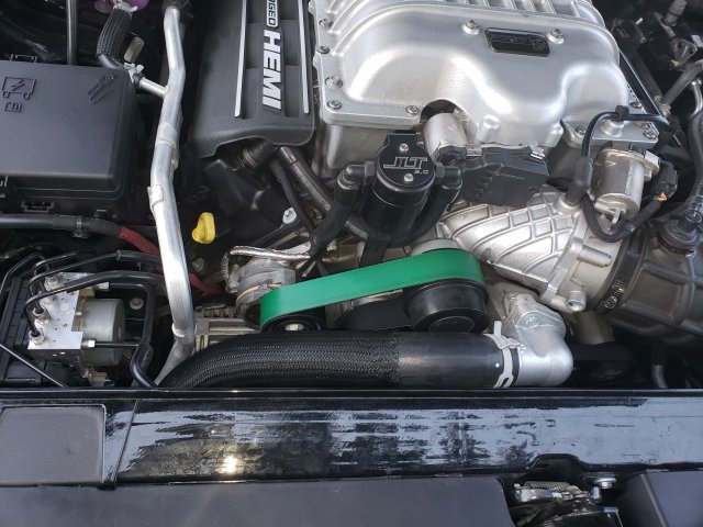

Thanks to those that posted issues with supercharger belts. I was enjoying multiple liesurely drives around Sebring International this weekend and broke a supercharger belt at 16171miles, 25 months in service. which popped a P012B code Saturday afternoon. Still runs, but goes into limp mode and gives you about 1100 rpm. I had acquired a spare Gates HD Green belt and had it with me, just in case. Wish I would've had my serpentine belt tool kit, but it is doable with a long 3/8 ratched and a wrench for the SC belt tensioner. The accessory belt has to come off to install the SC belt and three hands (and a search for a belt diagram) is good for that task. Since I had the belt I was back in the game fairly quickly.
Supercharger belt Gates #K100579HD Motion Industries in Braselton GA, for only $43.88
Ran fine today and the CEL went away quickly. Sure surprised a lot of Corvette and Porsche guys!

I found the issue to be threading the belt itself into position, not the pulleys or hardware.
